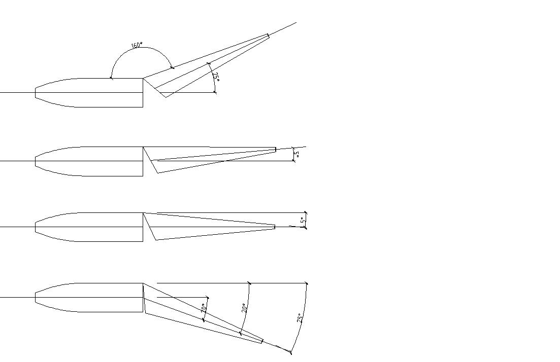

Hi All, Where is the 25 Deg up and 20 Deg down travel referenced to? I’ve been
using the top surface of the horiz stab to the top surface of the elevator. But
because the elevator is a triangle, will the down travel measurement be correct?
Thanks!
Rick

I believe the measurements are to the chord of the elevator…so you will need to adjust your measurements by 5 degrees.

Rick
I think Frank is correct, need to adjust by 5 deg if working from the top surfaces only. For elevator neutral the top surface is down 5 deg in relation to the stabiliser top surface. With top skin of elevator aligned with the top skin of the stabiliser go up 20 deg to achieve 25 deg up. For down with top surfaces aligned go down 25 deg to achieve 20 deg.
Because a picture means a thousand words
elevator travel.jpg (39.39 KiB) Viewed 4108 times
SNX-T01. is the drawing. For the 25 deg up it is shown as a 160 deg arc from top surface to top surface, stabiliser to elevator.
Steve
Sonex 892
VH-ZSX TD 3300

Thank you Frank and Steve! This is good information! I totally confused myself with
all the different measurements! I think I’m good now, the elevator is set properly
and on to the next challenge!
Rick
