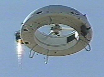

Years ago we put leading edge tape on the rotor blades of the Cypher UAV at Sikorsky and it would no longer hover. Those were much thinner airfoils but it cemented a bias in my brain and I would not do it. What are you protecting the leading edges from? Bugs, rocks, rain, or something else?
