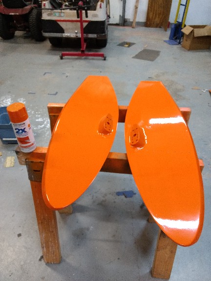

I used these:
https://www.thingiverse.com/thing:2508987
Kevin designed a set for Whelen Orion lights and one for AeroLed Pulsar NXP lights.
Installation:
viewtopic.php?f=39&t=578&start=1140
