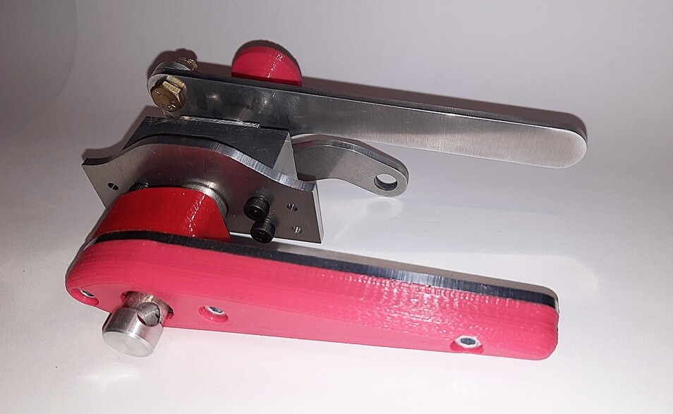

Seeing Graeme has already given me a plug I’ll add some information. In the photo below of the B model canopy latch you can see a 6mm hole through the press-release button on the outside handle. You can fit a small padlock through that hole to prevent the canopy from being opened.
Let’s face it; it’s only going to keep honest people out, but that’s pretty much the case with the standard Sonex arrangement too.

Second. I LOVE my Peter Anson latch. So positive and secure from inside or out (put a padlock through the hole in the external push button.

The Anson latch - you HAVE to engage it fully as part of a ONE step operation to close and lock the canopy.
The Anson latch has an advantage of being able to be operated from outside by a rescuer. If you pin yourself into the cockpit - it’s a bit harder for rescuers.
Disclosure - I have the Anson latch…
