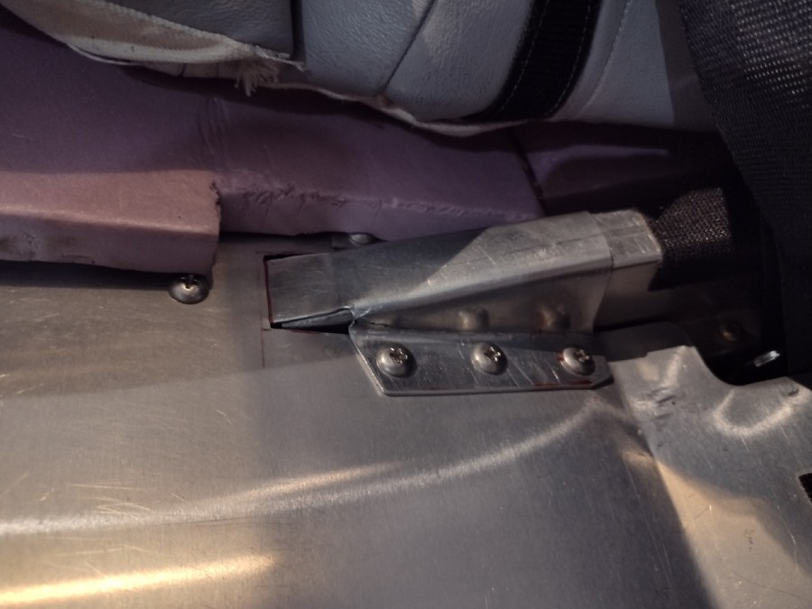

Here is how I reinforced the seat sling where yours tore:
I bent up a piece of aluminum to nest on the elevator pushrod cover. It has a tab that extends forward and goes under the seat sling. There are 7 screws total retaining it.
Mine is a tailwheel configuration so I can’t offer any advice on your maingear interference.

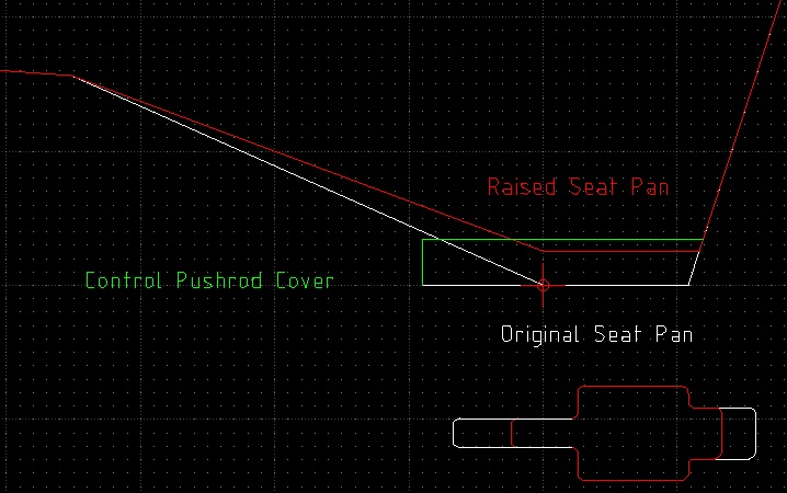

Re: Seat Pan Failure
Posted: Mon Aug 29, 2022 6:21 pm
by phenry
Bryan,
Thanks for the replies.
You have been very helpful.

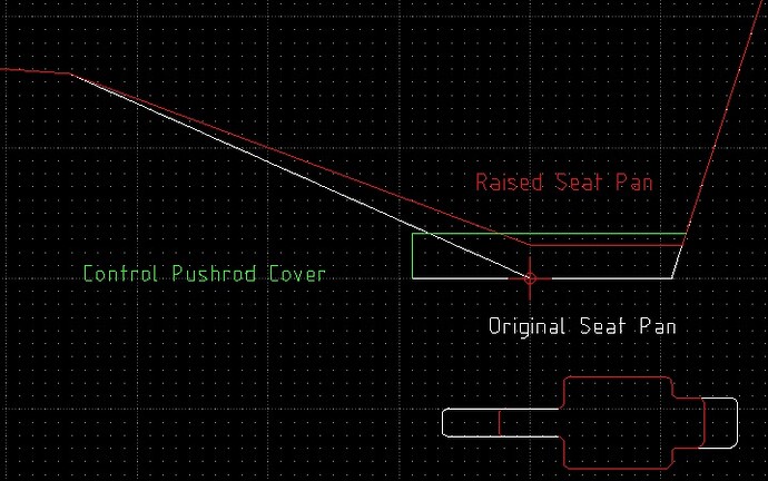

I am going to make a whole new seat and raise it by 25mm. (see picture below)
I am going to grind off the tab like you have done.
I am also going to make a part to go over the Control Pushrod Cover as you have done. Will extend to act as a doubler and insert from underneath.
I might add, this is not what I had planned for the next few days.
Seat Fix.jpg (104.66 KiB) Viewed 1157 times
