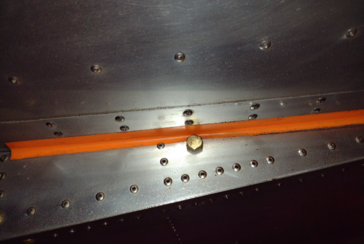

I can see how the inside seat belts attach to the center but how do I bolt the outside seat belts?
Do I drill a hole in the fuselage and put the bolts on the outside?
Pictures?
advTHANKSance
Dkb

Not sure if the classic and desirable A model is the same, but I think maybe mine has a bolt through the side. It’s hidden by the wing. I’ll take a picture next time I’m at the hangar.

I’m pretty sure the bolt goes through the side and the bolt head is outside under the wing.
seatbelt hole.JPG (105.43 KiB) Viewed 4618 times

Yup!
That is exactly how it looks. I forgot it is hidden by the wing.
Thanx!
Bryan Cotton wrote:I’m pretty sure the bolt goes through the side and the bolt head is outside under the wing.
