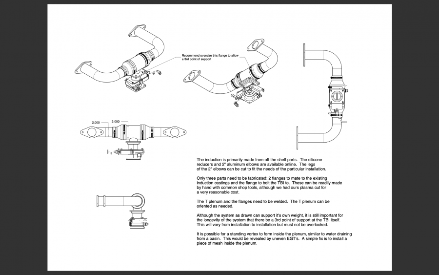

TBI induction copy.pdf
(544.37 KiB) Downloaded 310 times
If you can open the attachment, this is what I copied, it was sent to me for guidance by Rotec.
I have the early sensenich prop that Sonex sells, it was never tested with the original carbs but other reports found it should be close to 5200 static. Single TBI 40 used

The attachment didn’t work so here are a couple of screen shots of it.
Thanks. The attachment worked fine for me. Have you been told by users that this works as shown? I’d certainly be suspicious just from the hard 90 degree turn the air has to make out of the TBI, and the back and forth motion that must be going on inside that larger piece of tubing. I’d have to think about that some more.
