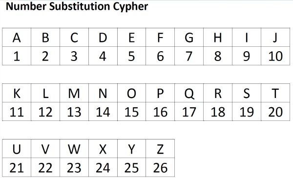

I ve been loking at that propeller code before, as its visible in one of the pictures of your plane… I unseccesfully tried to decode it…
-GT2 beign the brand and type maybe
-173 is diameter in centimeters
-VRR-FW maybe having something to do with pitch <----------- Any ideas???
-101 is the bolt pattern for sure, 101,6 thats 4"inches
Tried thing like this but it may be more intrincate
V + R + R = 22+18+18 = 62
FW possibly means sepparately 6 and 23 62,3?
Yes, i was really trying to find out what propeller was that XD
