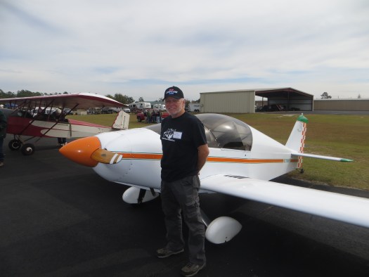

There is a Sonex builder that is putting a flywheel end drive VW on his build. It makes a lot of sense really as that is the business end of the engine. We use the transmission (business) end of the Corvair and the William Wynne conversion places the flywheel on the front like many certified engines do.
Having the flywheel in front means a better cowling can be used with a real spinner that aids cooling & (IMHO) makes the front of the Sonex not quite so homely looking. 8~) I find it to be a very muscular look (again IMHO):
