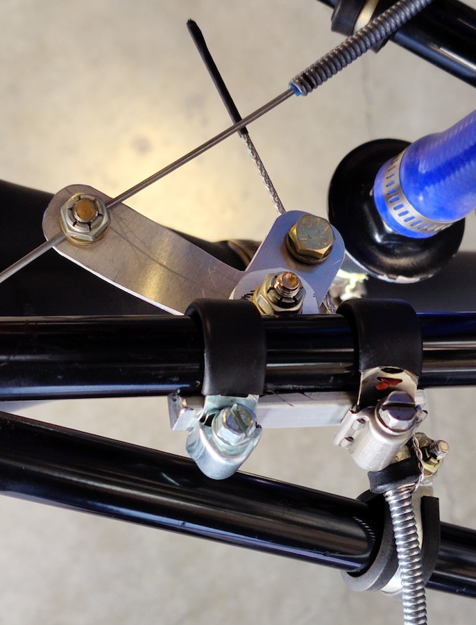

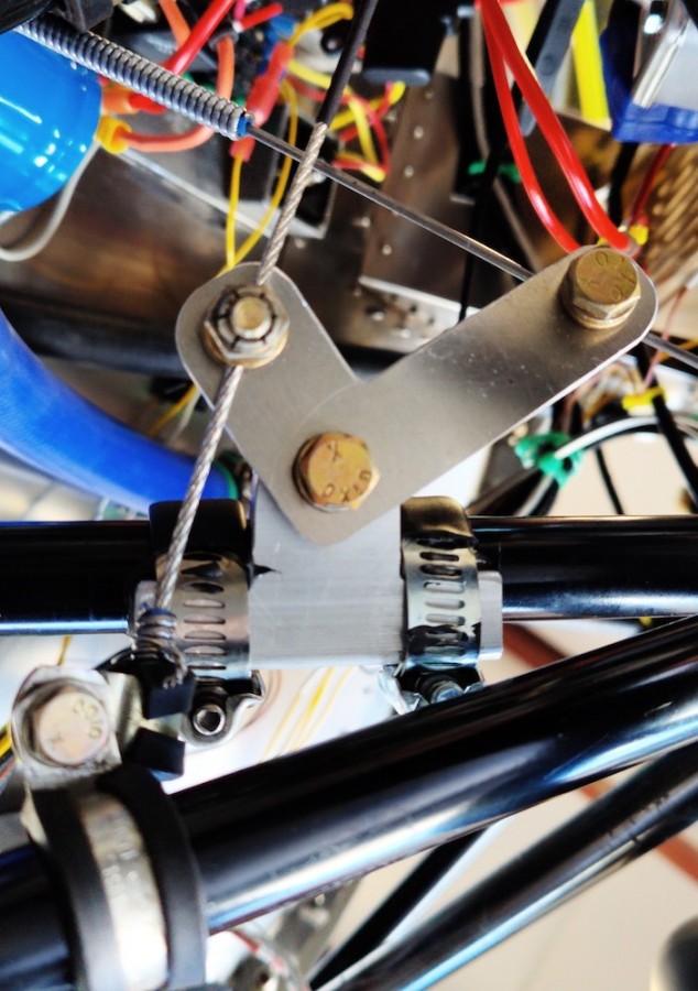

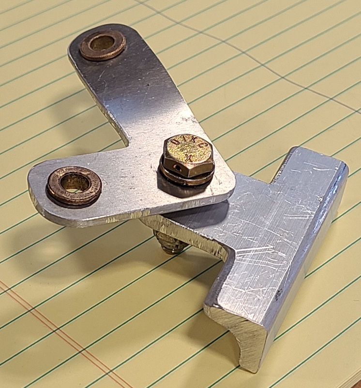

First off I needed to fabricate a cable reversal bell crank. I built it such that 3" pull on the control is 1.5" push on the aeroInjector. Sorry the pictures are so large, you’ll have to click on them to see the full image.
The bellcrank base is made from 2" angle. The radius didn’t quite fit the 1/2" Diameter engine mount tube but with some sanding it was not far off. Then the radius was liberally filled with RTV and loosely set in place to dry before tightening the hose clamps. The hose clamps are protected with Adel clamp rubber strips so as to not damage the mount.
With the engine off the control works smooth as butter but there is a bit of resistance felt when accelerating. Thinking this is normal as a sucking engine will pull that slide tight. It’s not too much, just different.

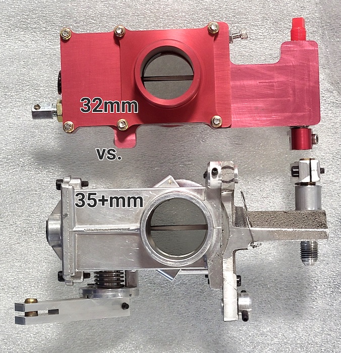

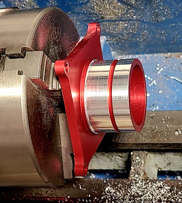

The RevFlow carb is 35+mm which was replaced with the 32mm AeroInjector. 32mm works well. I noticed right away that the S flange almost fit into the Revmaster flared intake tube and that sizing was such that a rubber coupler would be problamatic. So I drilled and slit the end of the revmaster flared intake flange so that a hose clamp could be used on it. Next I turned down the S-flange by .020’ which fit perfectly…
From this angle these carbs look about the same in size. But the AeroInjector feels about half the weight of the RevFlow carb.

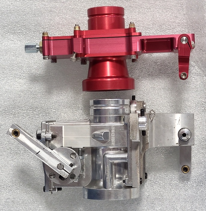

Here you can see where all that extra weight comes from.
The drilled hole and slit (under the first hose clamp) in the intake tube is covered completely by the S-flange. It was also sealed with a bit of RTV to boot. The second hose clamp is only for the safety wire attachment.
