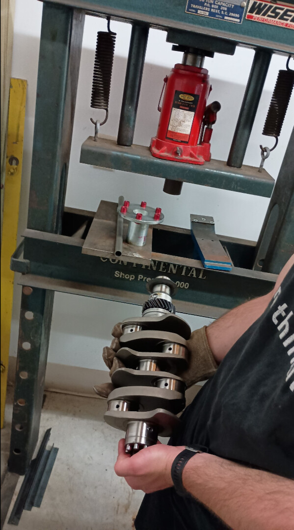

I just did this during my engine rebuild. Sonex specifically says to use a hydraulic press and do NOT use HEAT.
Find a powerful hydraulic press the maintenance shops at BUU didn’t have enough force. I lucked out with a guy in Burlington who owns an auto repair shop and is also very well known in the experimental helicopter world. He took a large bearing splitter around the base of the hub (where the oil singer is) and hung the whole assembly from that. Remove the hub bolt and drop a couple of impact sockets in to give the press something to press on. We expected a smooth push out but it released with one large bang.
Don’t mess around with anything else. Total procedure time was less than 5 minutes. The correct tools make it a piece of cake.
We got the written instructions from Sonex, which were to press it off cold. I found a socket that fit inside the prop hub and rested on the crank. Our EAA chapter has a 30 ton press and it came off easily - smooth and steady, no bang.

Yep, 1414. You can contact any chapter member that will let you in and hang out until it’s done. I’d recommend me, since I’ve done it before.
