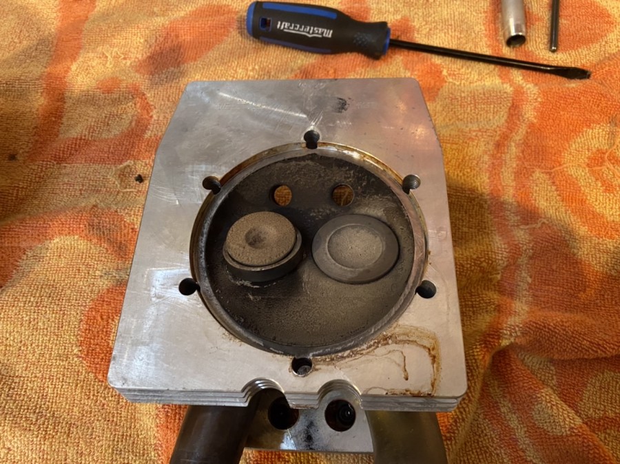

Hey everyone. Sorry for the delay in the responses here. First thanks for all the reply’s and advice. I’ve been talking to Nick at Jabiru USA. After sending the two pics to Nick and talking with him it sure seemed that he wasn’t surprised at this happening.
After, seeing this and pulling the pushrods out really did not see any damage to the rod or the valve. After talking with Nick and Saying that a good possibility is carbon build up if the engine runs rich. So, too pull the heads and check for carbon build up.
Had a good friend who’s an AME help me with this. Once we took the heads off which was pretty simple we found that on both cylinders, it was actually the valve seat that popped out ??? which lead to the valve sticking and not closing fully.
Number 2 cylinder
Number 4 cylinder
Pulled the valve and seems ok but a little damage to the head where the seat goes. Possibly and hopefully get it fixed.
Number 4
Checked the tops of the pistons and found a scratches which could be dealt with easily. Heckled the walls and all is good there thank god.
Damage.
So, now my concern is that Jabiru says because it’s an older 2200 they don’t make those heads any longer. So, hopefully they can be fixed.
Mark

From my almost 10 years with the Jab 22A in my Sonex, I recall that any discussion about these units must start with the engine serial no. The build variatons over time have been so numerous that anything else is meaningless. A mech lifter engine like yours with the black starter motor housing would indicate an early gen 2 unit- serial # something in the early one thousands??
Cooling the wide finned heads on these units, is an absolute requirement for safe operation. Jab suggests a max cht of something around 175C under the plug, and 150C continuous. I am sure that is fine, but it really does not address the critical area, namely around the bottom head bolt (the one under the rocker box plug). Personally I would always tighten my buttock muscles if I saw anything close to 140C max wot there. I know that with the notoriously unreliable cht instrumentation they have foisted upon the flying community, this is opening a can of worms: where to hook up the sensor??
What happens is this: the head is not sufficiently cooled down there, the aluminium in the heads are locally going plastic, and gradually you are loosing clamping force under the head bolts- especially the lower one. Sooner or later you will have a leaking sealing surface evidenced by some (miniscule remnants) burnt lube oil. That is when the shit hits the fan- your cylinder egt creeps up: not much, mind you, perhaps not enough to cause any alarm from gage readings, but enough to heat up your head so much more that placticy increases and the valve seats are loosing their crimp: the seats are on their way out! By the way, IMHO egt limits (680-720C) set by Jab are far too optimistic: 620-650 gives me more ease of mind.
Getting plastic heads back into shape is an almost impossible task- it has been tried numerous times before with disappointing results. Many have turned to a more bullet proof solution- install liquid cooled heads, a radiator and a circulation pump. True, it is a lot of work- but it also gives piece of mind! The final result could be looking something like this:

You are correct with your assumptions about the valve seats. But technically speaking, here we go, plasticity is not a metallurgical term. Yield strength comes close to it. That’s the strength at which it yields and does not spring back. Aluminum expands four times as much as steel valve seat when it’s heated. micro inches/degree C. per inch. That’s probably why they put a max on head temp. When an alum head expands the holes get larger not smaller. Valve seats have to be shrink fit when they are installed, by several methods, and pressed into the seat in order to be able to absorb the heat expansion without coming loose. The head goes through an expansion/contraction cycle with every engine run which might also tend to loosen head bolts. It would be a good idea to torque check them once in a while. I need change for my two cents worth.
