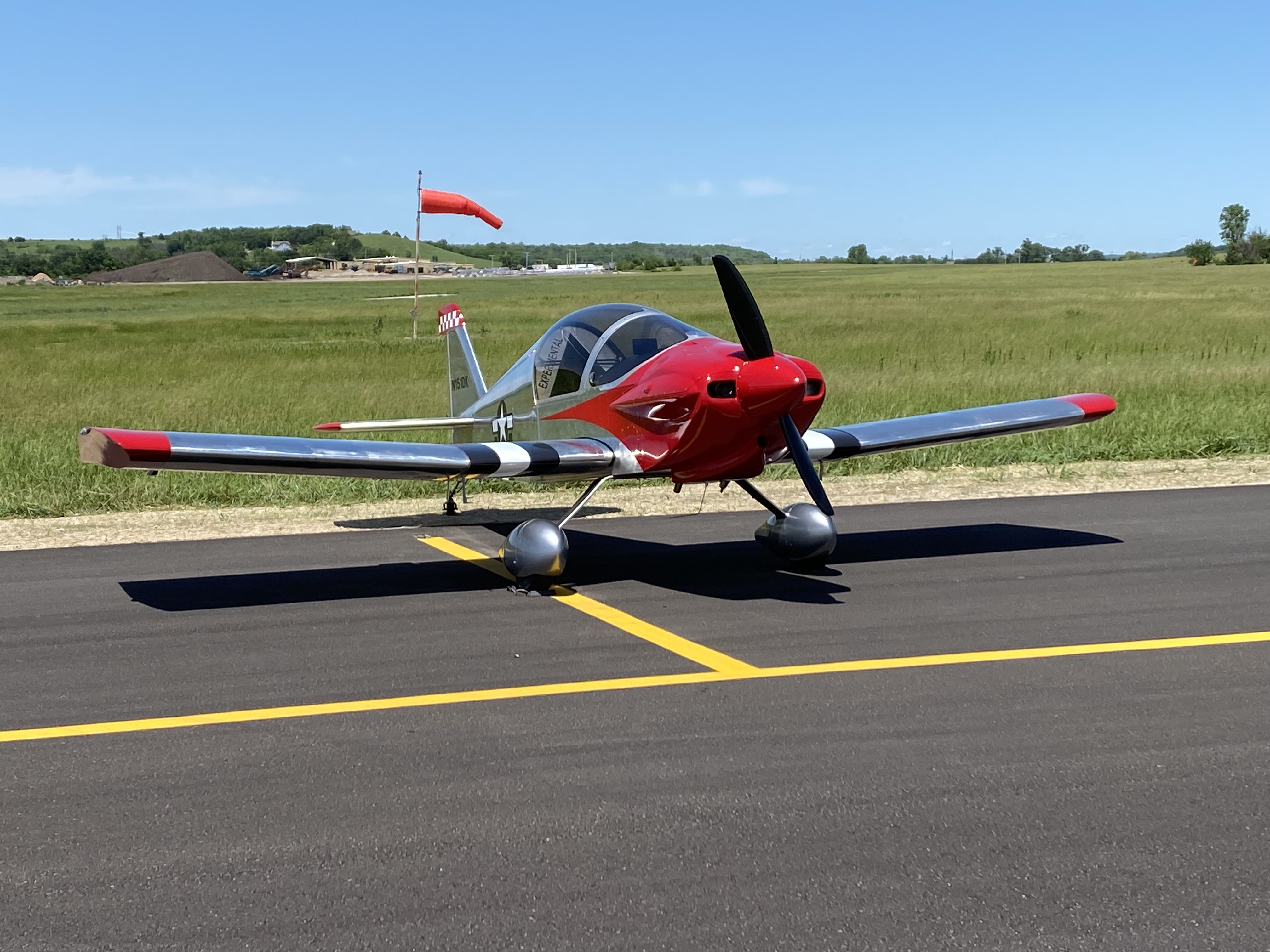

I’m currently running a Sensenich 54x58 prop on my 2850 Corvair powered Onex.
I’m looking to try a prop with more diameter and/or less pitch, maybe a 54x56 or 62x51 or anything in-between.
