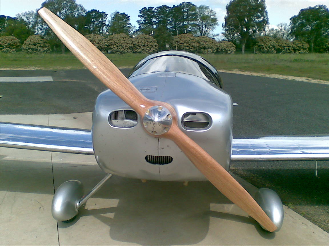

For those that like experimenting and have a bit of patience and free time you can roll your own for about $80 worth of materials. Here are a couple of pics of the 2 props I’ve made and have been using. I ran prototype 2 for the first 20 hrs and prototype 3 for the last 65hrs. Prototype 1 has only been used as a test club on ground runs.
For the design I bought a JC Propellor design program and thoroughly recommend it. The program runs on excel and will produce a design for 6 different styles and can also do 3 and 4 blade designs. Even if you dont want to make a prop it can be used as a tool for prop selection. Oh by the way I have no connection to JC propellor.
I’m now in the process of completing a new fibreglass spinner total parts weigh just over 1 lb this will replace 3.5 lbs of billet spinner

Charlie. Static rpm with the 64" prop is 2850rpm 24"Mp, climbout sees 2900rpm 27"Mp. At WOT in flight it revs out to between to 3100 and 3150rpm, at WOT I have seen 160 knots IAS in smooth air. I normally cruise at 2700rpm which achieves an average of 130 knots at 19 litres per hour. 2800rpm is close to 140 knots and 23 litres per hour
Now its definitely not a climb prop. The best climb rate I see solo on a cold day is about 1400 to 1500fpm. Flown solo it is almost always over 1000fpm. If its hot and heavy it doesnt climb real good. The worst I have seen at gross on a hot day 38 degrees C was between 400 and 500 fpm.
For the next prop I’ll be aiming for 62" pitch.

Mike and Vic. The program is fairly simple to use. Its uses excel, just need to enter data in the fields such as RPM, speeds, HP, airframe type (slippery or draggy) diameter, type of wood etc. It took a little playing around with these fields to get the prop pitch I wanted. From this it will produce performance graphs and plotted airfoil section drawings for seven stations along with a table of coordinates for each station. I then copy these coordinates over to autocad manually to draw each station and from these drawings I make a plan view template of the prop shape. This is used to mark out the blanks. These could also be drawn by hand with a ruler and French curves.
top templates
I do all the carving by hand but with powertools mostly.
1/Bandsaw to cut out the blanks and drill a centre hole which becomes the reference for absolutely everything.
2/Reciprocating saw to cut down to the station marks in the glued blanks, carefully stopping about 1/8" proud
blanks with depth cuts
3/Electric plane to to rip it down to these cuts.
4/ File carefully to go down to final shape at each station, a vixen file would do for this,
5/Angle grinder with a 40 grit flap disc fitted to knock down the high bits.
grinding off the high bits
6/Belt sander to bring it down to final shape starting with 40grit progressing to finer grades
7/Sanding by hand
I do steps 3,4,5 and 6 on the rear or bottom blade first then repeat the process on the top or front of the blade. As soon as I start with the belt sander on the top of the blade I start looking at the horizontal balance.
Thats how I have done it I’m no expert. It takes me about 60 hrs to do each one and its a dirty and dusty job
