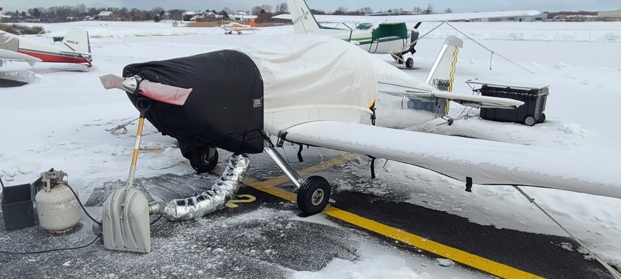

I have a 30,000 btu propane heater that I could plug into an inverter on my truck to use. Experimenting at home with a temp gun I am getting over 500 degrees out of the end an aluminum tube. I’m thinking this is to hot and it may damage the cowling. Thoughts? Too hot?

Sounds a bit hot. I have a Red Dragon - I set it that I can JUST keep my hand in the warm output where it is going into the bottom of the cowl.
Red Dragon - 30-45 mins till the front jugs are warm to touch. Start like a warm summer day.

I agree with Graeme; 500 degrees will be hot enough to soften or possibly melt the fiberglass or at the very least, burn up the paint on the cowling. That’s pretty darn hot and I personally wouldn’t use that much heat. I tend to favor warm air and longer durations of preheat. Remember, you just want the engine and oil to warm up a little to help with engine start. It doesn’t need to be red hot!

I was thinking it was too hot, wanted to hear from others. Thanks guys

jrs wrote:I’s sure someone here has looked at this but back when I was with GM I remember an engine block heater that we sold for the northern states. Simply plug it in and and it warmed the engine, I believe that it warmed oil. I googled engine block heater and found that there is a dipstick version which might work without doing any drilling on the block. Has anyone explored this ?
From other experience:
So you need electricity - which I don’t have in the tie downs…
Dipstick heater - if left on, Notorious for “sweating” during humidity cycles and so filling the engine with corrosive steam.
Block heating - usually with heater bands around the base of the cylinders (quite possible on the AeroVee) and a “pad” on the bottom of the sump to overall warm the oil in the sump and engine. Not sure how you would get the pad to work on an AeroVee - not a lot of flat surface to work with.

I’m thinking a portable generator with a electric heater. This would be for late fall and early spring, not dead of winter. I took a temp of my wife’s hairdryer and it was about 180 degrees. Seems like that would work.
