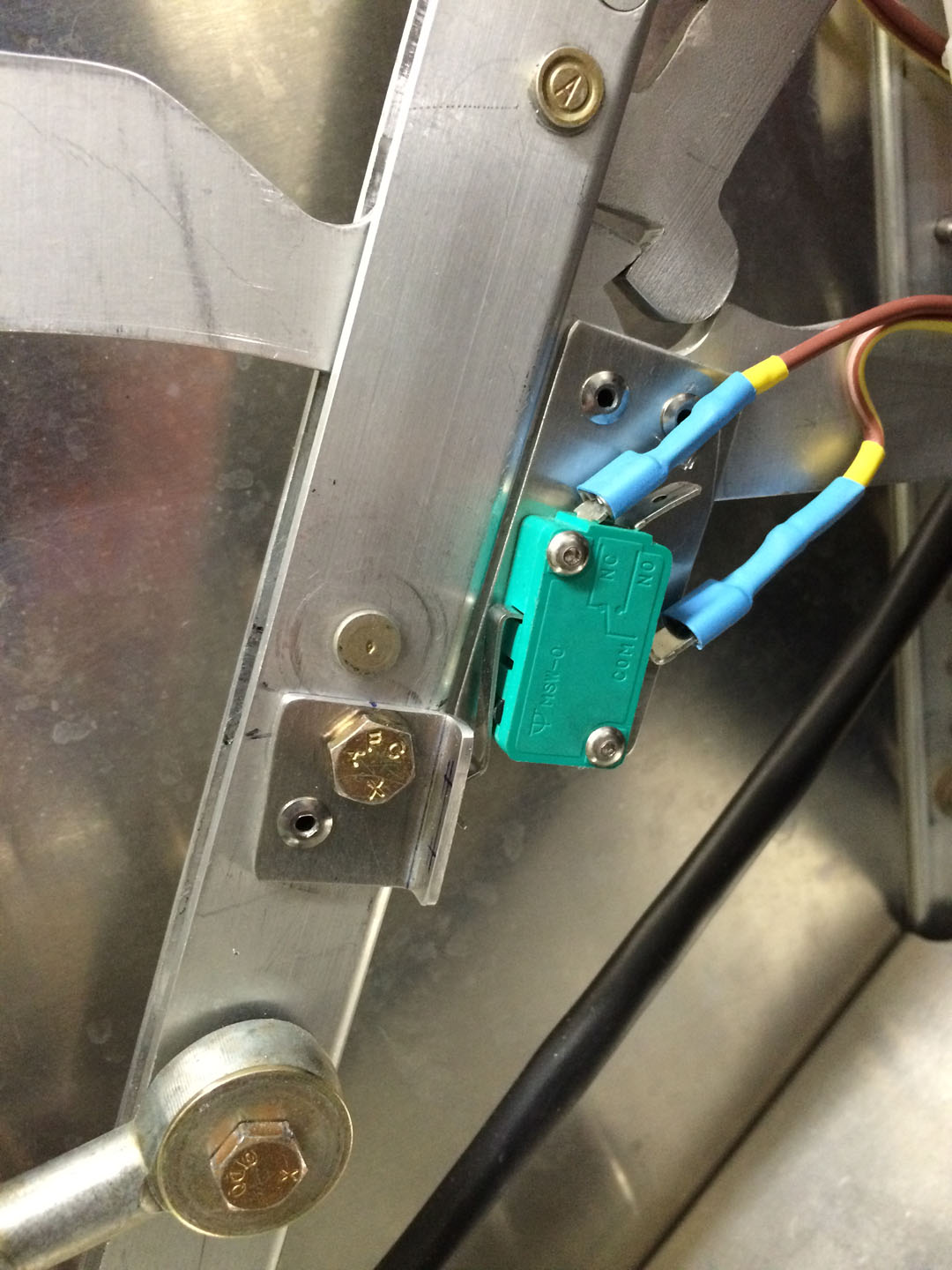

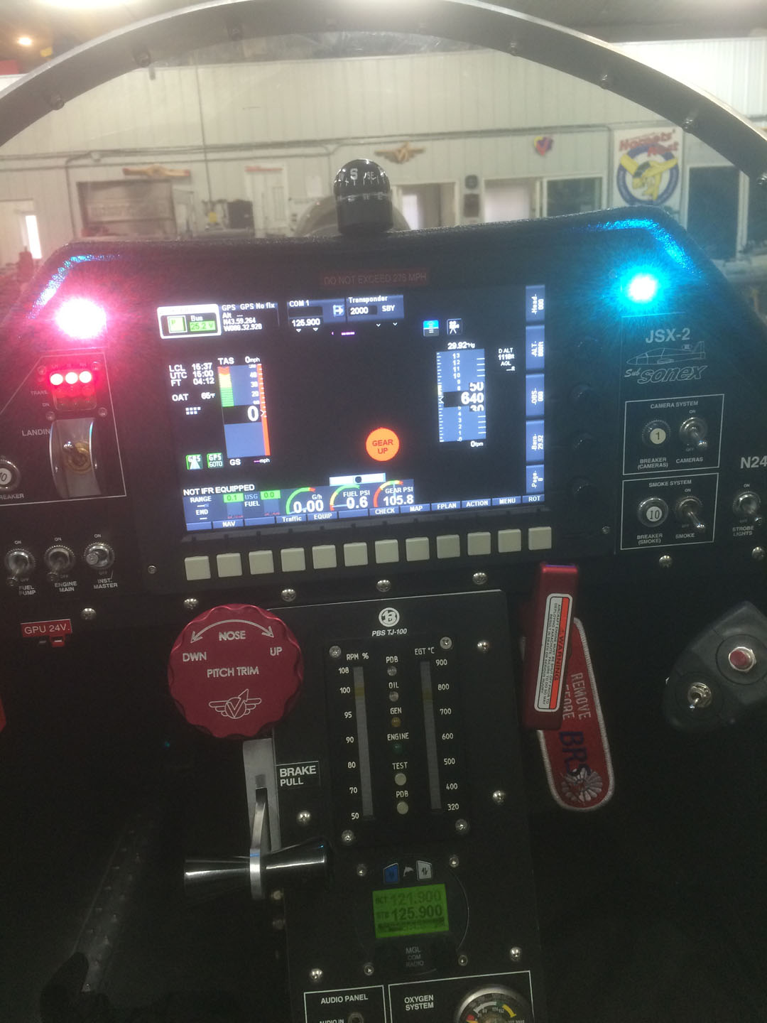

Since the Oshkosh gear-up, John has been busy devising a very simple gear warning system – you know what they say about the mother of invention… The LED warning light system uses an interlock between the flap handle and gear indicator. If flaps are extended with the gear-up, bright multi-color LED’s at the top of the instrument panel will flash until you extend the gear. We’ll have all of the electronic components and installation instructions for that system included in an update package to be sent to SubSonex customers next week. MGL Avionics is also working on a firmware update for the iEFIS Explorer instrument to allow a gear warning indication to show-up on the iEFIS display using a single-wire input from the gear warning system electronics package we are providing. Pre-programmed SubSonex checklists will also be available for the iEFIS Explorer avionics package soon.
Gear Warn LED Lights (Upper Left and Right corners of panel) flash and change colors, and MGL iEFIS screen Gear Warn Indication (Flaps DOWN, Gear UP):

Gear Warn Switch Senses Flap Position (Zero Flaps Shown Here):
