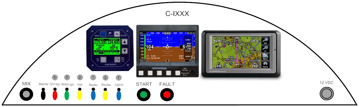

Hi,
I am Onex11 delivery due for august 2011. In the meantime, I have been spending my spare time dreaming my future panel. Here is my first pass:

I am still in the dreaming/saving stage. I’m planning on a sonex… but I have been thinking of a very similar panel as yours with the Xtreme on the left, Garmin on the right and small “stack” of 2 1/4 com/transponder in the middle. I’ve got a microair that I picked up discounted. I’ve heard mixed reviews on it. Hopefully it will work out.

With an expected delivery date in August, I gather onex11 refers to your reservation number. Wish that I has pulled the trigger sooner, #89 here. I waited until I went up there for the Builders Workshop.
Do you have the actual dimensions of the panel? I should have made a few measurements and detailed photos when I was there.

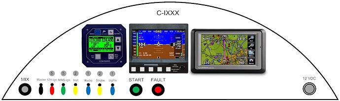

Yes Onex11 means 11th position. I was at the workshop myself. The actual PDF drawing of the Sonex proto panel (the one we saw at the workshop) is on Sonex Onex info web page: http://www.sonexaircraft.com/research/u … 42911.html
This is another one with the Enigma EFIS:

Hi Chris: I see you are in Canada…like me. I’m building a Sonex. I was talking to my MD inspector about the
enigma I want to use. He says the regs say we need to have non electronic ASI, VSI and ALT. But if the electronic gauges
have battery backup, we MAY be OK. I sure hope I dont need steam gauges…the panel is too small as it is!
Before you cut metal for the panel, it would be good to check with your inspector, to see what he says.

I sure hope we don’t need steam gauges ! I just installed an Xtreme in my RV-4 and was going to pull all the old gauges . I guess I better look into this .
I haven’t started playing around with panel configurations yet but I would try to keep the EFIS centered in the panel . Having it offset messes with my OCD !
