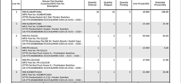

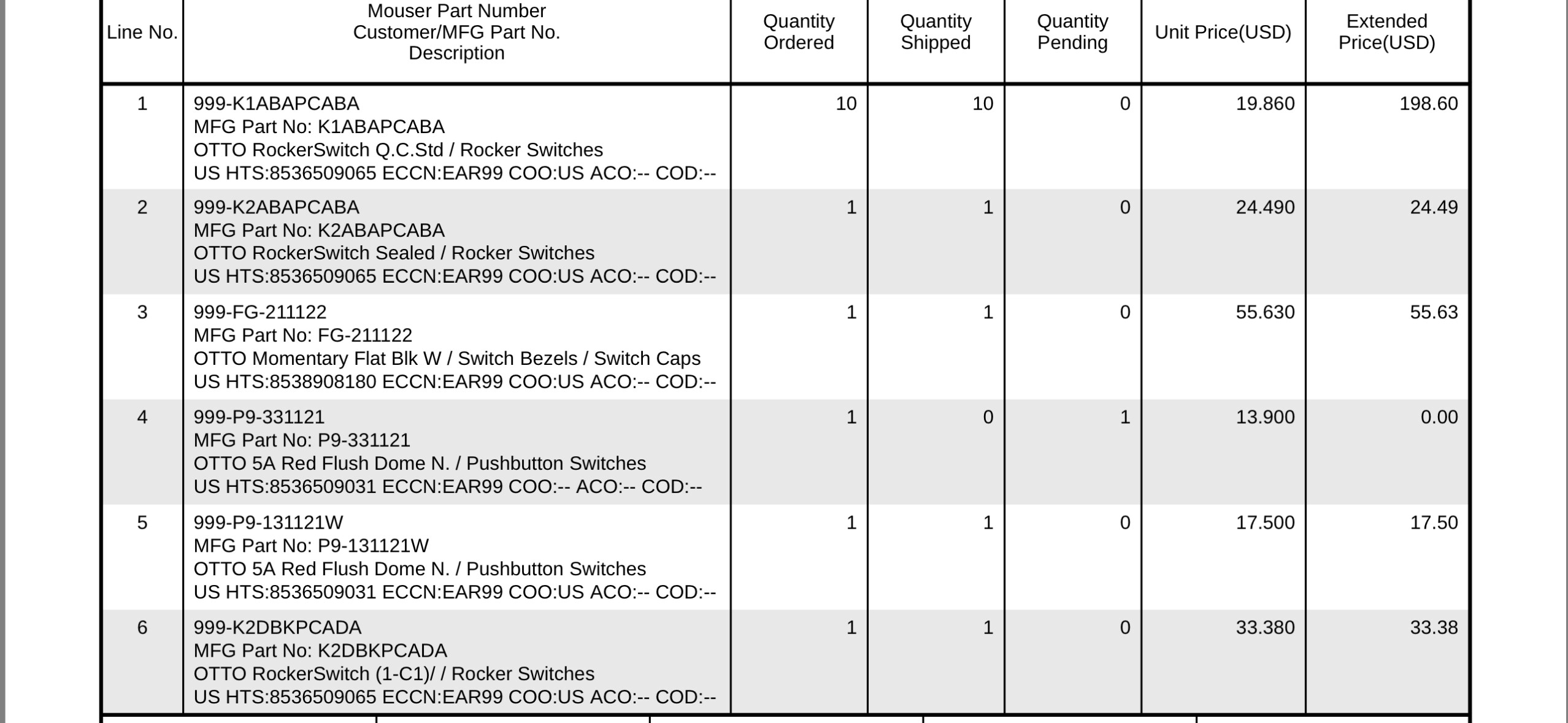

Hi,
I am about to order some switches. I am interested in exactly which switches you chose :folded_hands:
Hi Wes,
A screenshot of my Mouser invoice is attached to give you some ideas.
See: DOG Aviation John's RV-12 Blog: RV-12 Panel Switches Sourced – A Duh Moment
Thanks a bunch! I’ll give them a look.
