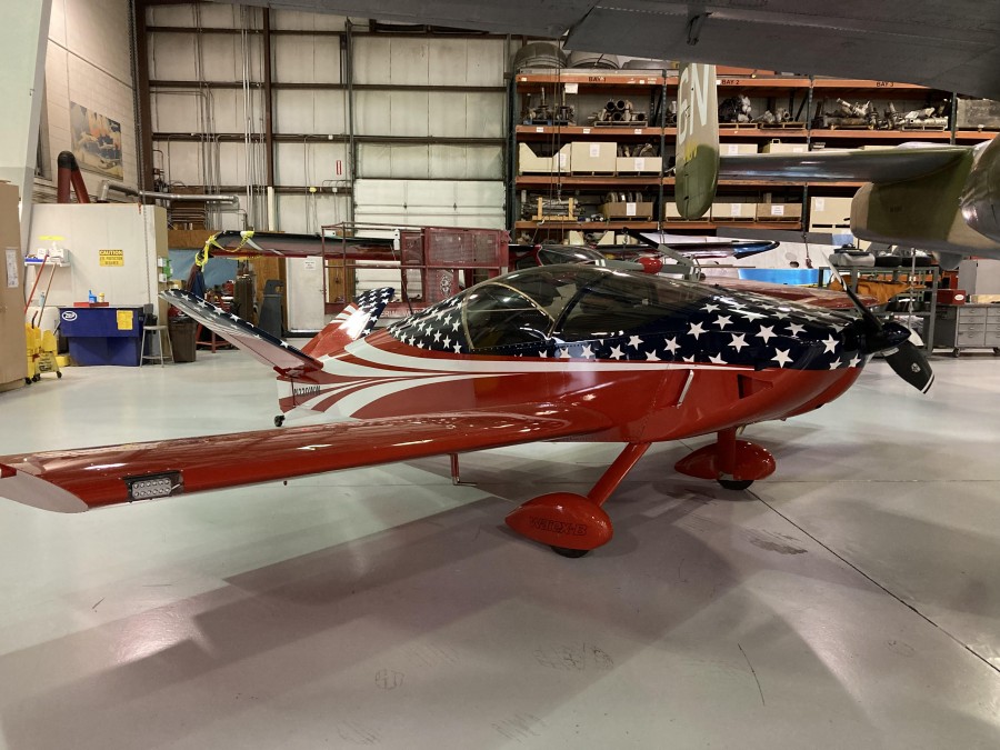

by Sonerai13
For those who haven’t seen the airplane since it was painted, here she is sitting in the EAA Kermit Weeks hangar.
