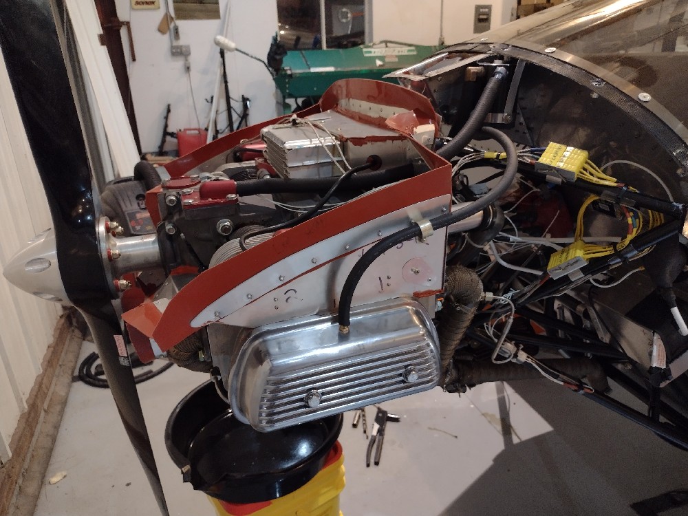

Hello AeroVee drivers. My Sonex has the original Oil/Air Separator installed, the slanted one shaped to fit the slanted firewall. I’m also using it as a catch can for oil that passes through the crankcase breather tube. After every flight I have to drain 2 to 4 ounces of oil from the separator. It works fine and is just a minor inconvenience. There is no water in the oil I drain. I’ve got a little over 100 flight time hours on the engine. I’ve been contemplating adding a return line to the valve cover on the right side of the engine about halfway down the backside of the cover. I mention that in case I can’t attach a picture. Does anyone see a problem or potential issue with doing that? If the picture posts I can’t figure out how to orient it correctly.

I routed mine to the top of the valve cover. I’m happy with it.

Thanks Bryan. I would rather have the line return to the top also. Unfortunately, my separator is placed in a bad position for that. I mounted it according to the Sonex instructions which places it lower on the firewall. They originally designed it to return oil to the oil sump plate. I just don’t like that idea too much. I could change out my separator , but only if my planned location for the return line is a bad one. Have fun flying.

Mine also returns to the top of the valve cover:

I have mine installed on the rear of the valve cover so the hose is downhill all the way from the seperator to the valve cover., never had a problem. I used an AN flair fitting so it is easy to remove for maintenance.

Thanks Jerry. That is exactly what I intended to do unless there was a reason that I shouldn’t. Since there doesn’t appear to be a problem, I will continue on.

It’s just PVC pipe with some plastic scrub pad inside. It probably weighs a little more than your cell phone does. I got the idea from somebody’s automobile page years ago. Here’s one I found by Googling: https://www.tacomaworld.com/threads/diy … an.244981/
Mine also goes to a catch-can in case it backs up or gets blocked. The catch-can also has a vent. I check the can at every annual, and have not found any oil in there.
