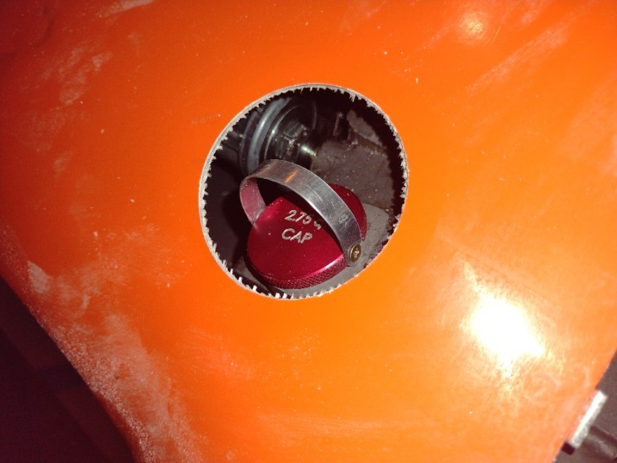

I drilled and tapped a couple of holes on the edge of the oil cap for 4-40 screws. Then I made/screwed on a handle. I holesawed access above the oil fill. That’s a 2 3/8" hole.

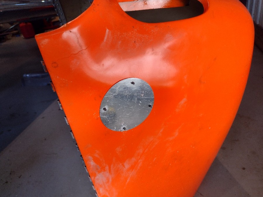

I had a few disasters trying to make a cover with the flycutter. Ended up having my son talk me through how to set up the part on our CNC router.
https://www.youtube.com/watch?v=BUq5OGHzZB8
Needs nutplates and screws. Maybe some paint.
