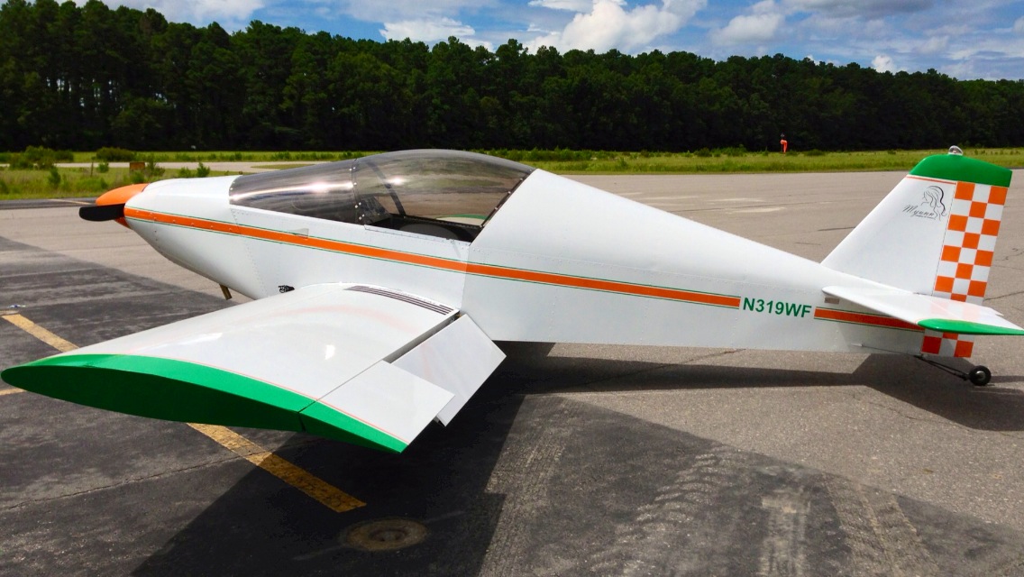

Just to clarify a bit … my OAT is in the NACA vent (on the pilot side of the fuselage) that is for cockpit cooling. The sensor is far enough inside to keep the sun off of it. Not sure but seems that if you used a NACA vent on the cowl that the OAT could be compromised by engine heat. You can see the side vent in this photo:

Also have mine in the NACA vent on the pilot side for cockpit cooling air. Works perfectly.
