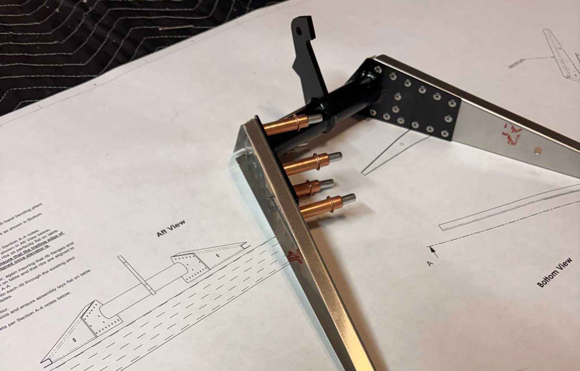

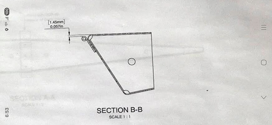

I did have one question about a picture in your build log. It has to do with the elevator and where the hinge attaches, Looking at IMG_6155, it shows the hinge attached to the elevator. My question, is in the pic it looks like the top of the hinge is actually above the top front edge of the elevator, but looking at the drawing for the elevator (SHX-H05. section B–B) it shows the hinge attached 0.057” below the top of the elevator. Maybe it’s just the angle of the picture, but I thought I’d ask about it. I’ll say in advance, the work is not too hard, but for me, interpreting the drawings is the biggest challenge.
I hope you don’t mind asking about a build question. If you don’t want to do that for some reason, I understand. Just let me know.

If the attachments worked I’ve got your IMG below and the section from the drawings too.
Matt, Forum is definitely for build questions! My hinge is indeed recessed below the top edge. Must just be the camera angle. I used one of my rulers as a shim under hinge with the flight control upside down to get the amount set. I actually just wrote on this topic for the next installment of the article. Find something that is really close to 1.45mm. I think what i used measured 1.55.
