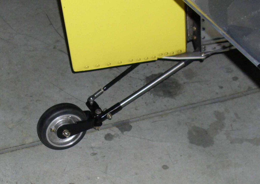

Hello, everyone. After many weeks of waiting for a prototype, I now have a new tailwheel bracket! After 340 landings I found myself dragging the tailwheel pivot bolt across airport ramps all over the country, not to mention the destruction of my ventral fin. Let’s face it, the stock tailwheel clearance may be good enough for the taxiways of Oshkosh but other airports hold many taxi “traps”, tie down rings, potholes, uneven pavement ect.
This bracket is made for the Van’s mini tailwheel…
http://www.vansaircraft.com/cgi-bin/cat … LW-t-wheel
Yes, it’s pricey but what is your beautiful ventral fin worth? The bearings are sealed and the tread will likely last way longer than the stock wheel. Three stock wheels will pay for one Van’s and I was ready to buy my third (one tread worn and the other with shot bearings).
If it appears that the clearance is tight from the tailwheel and the rudder in the picture, it was. I extended the production brackets 1/4 for clearance, mainly for the Waiex. The Sonex clearance was not a problem.
I made three landings today and steering authority seems to be improved. The overall ride…like a Cadillac… :lol: . Completly quiet and very smooth.

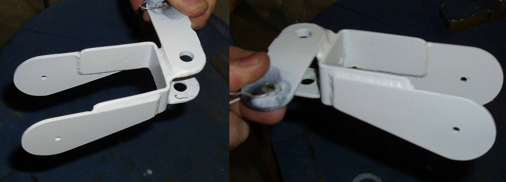

Bob Mika and I modified our original Sonex tailwheel brackets to take 5" wheels. This completely cured the problem of scraping the tailwheel bolt and also made for smoother taxiing…no more Sonex “thump” everytime you taxi over a crack in the pavement. We welded on some .090 plates to the side of the old bracket.

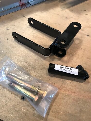

Posted: Fri Jul 12, 2019 2:40 pm
Improved Tailwheel Bracket
I have one of Kip’s improved T/W brackets, UNUSED, with the bolts and an also unused Sonex/Waiex tail wheel pivot. $75 shipping included.

Hello, everyone. After having 93 of these brackets in the field for over eight years, I have received two reports of cracks or failures of the bracket at the 90 degree bends of the main fork piece, both fairly recently.
Mine still looks as new but my rough/soft field operations are probably in the 2% of my total of 900 landings using the bracket. Others may subject the tailwheel area to higher stresses.
I think that any potential cracks before failure will be visible on preflight so please be sure to include this area during your inspection.
One fix (via Mike Smith) is the welding of triangle shaped doublers in the inside of the bend area if cracks are noted.
