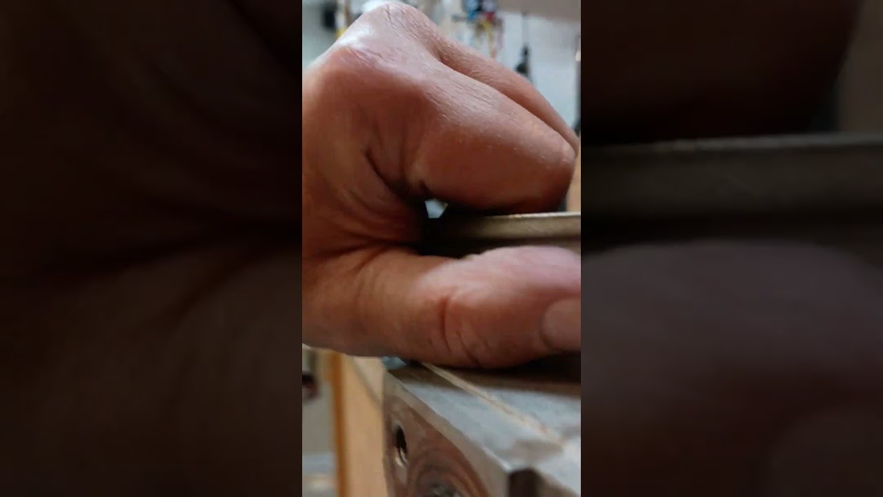

Joe, I think they are ok. The cooling fin casting quality is sometimes poor, but a little work can clean it up. Check out my video.
