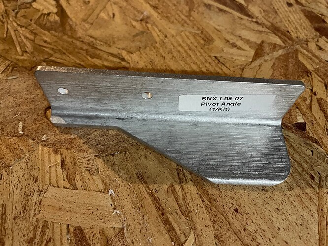

Got a non-local friend that has a Sonex A that he is re-assembling. He was not present for the disassembly and doesn’t know where a part goes. He did not get the plans with the aircraft. Thanks in advance.

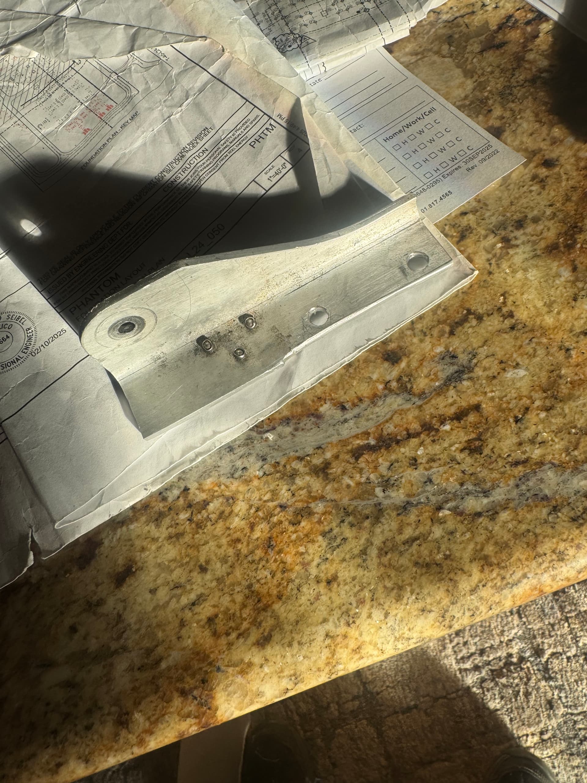

I don’t recognise that as any standard Sonex part. Whatever it is, the edge distance doesn’t look too good on a couple of those holes.

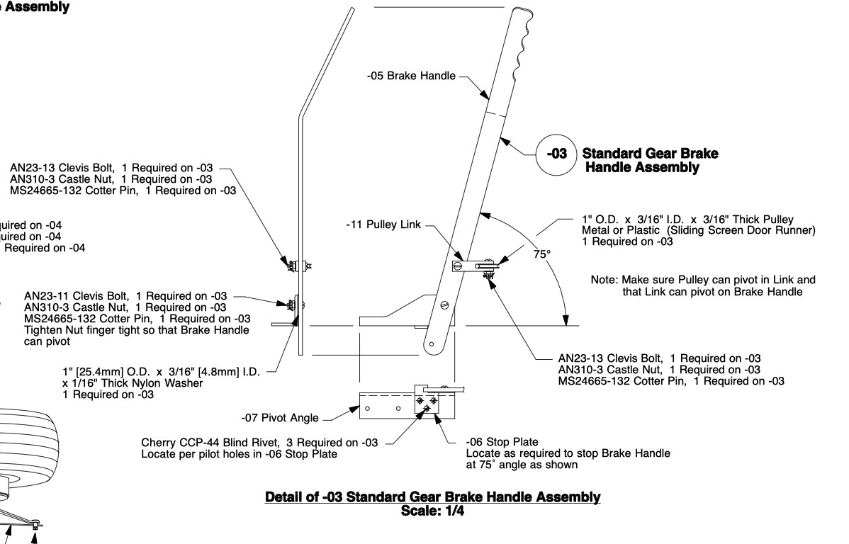

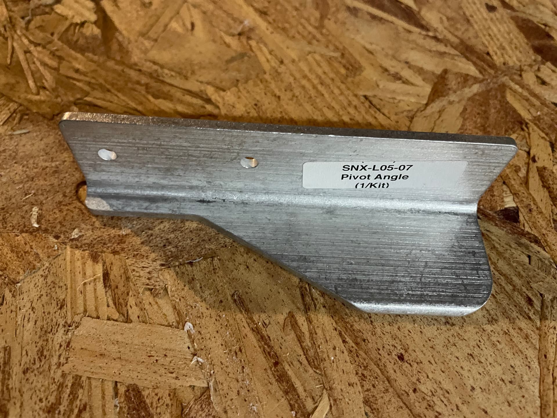

I didn’t recognize it because it’s still in the box. I believe it’s the below part used to attach the brake lever if you’re using drum brakes. Hopefully it was removed for a brake upgrade?
The part is indeed the hand brake pivot angle, per info provided by Sonex tech suipport
