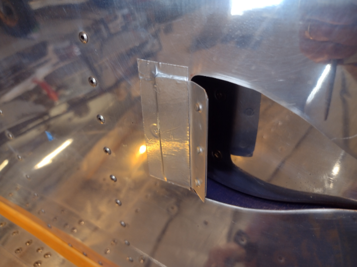

Posted: Sun Jul 16, 2023 7:31 pm
Here is an enhancement I made for my vents. It’s two pieces riveted together and it hooks on the back edge of the NACA vent. It might stay on without tape but I’m not sure.
