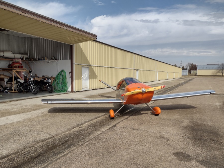

As I reported in another thread, our top cowl pin came forward and damaged our prop. I had retention built in but it was missed when we closed the fuel door. Had a generous offer to borrow a Sensenich prop while Lonnie fixes my P-Tip:
I bought the P-tip from Mike Farley when he put the turbo on his Waiex. It is more of a climb prop. I had typically been cruising at 100kts turning 3000 RPM. With the Sensenich I’m seeing more like 110 kts. Here is a little table for comparison:
Prop/ Static RPM/ Climb RPM/ Cruise at 3000’ / WOT
Prince/ 3000+/ 3150/ 100kts/ 118kts
Sensenich/ 3000+/ <3000/ 110kts/ 120kts
I hope that aligns good enough. I don’t have any comparison for takeoff distance at heavy weights. Solo it was great and I was climbing 800-1000fpm although I was turning less than 3000 RPM even at 90kts.

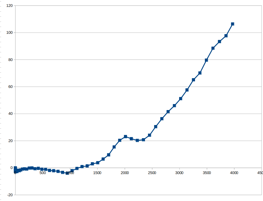

Here is takeoff performance test flight at 1141 lbs today. I think the Prince prop definitely did better, but I have to find that file.
X axis is feet of runway travel. Y axis is altitude. Note that we are still working on smoothness on the 3 point takeoffs. This one was a jump to ~20’ so not the best, but still valid data.
Sensenich takeoff performance.png (24.96 KiB) Viewed 2268 times
Runway 12
Winds 070@5
Temp +2C
Alt 30.07
3 point takeoff with one notch of flaps
Basically it took us 3000’ to clear a 50’ obstacle.

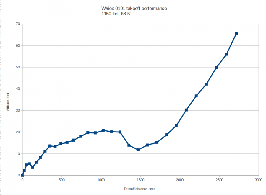

Here is my plot for the Prince prop at 1150 lbs from phase 1. I don’t have all the particulars of wind & temp handy, but 2500’ to clear a 50’ obstacle.
