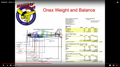

I am going to use a Rotax 912 ULS engine in my single place Onex experimental. This engine weighs about 170 lbs and it will be replacing the VW conversion engine normally in the Onex which weighs 190lbs. So I am doing the math below to figure out how many inches I need to move the new engine forward to compensate for its lighter weight. Using the weight and balance diagram below, the number of inches that the cg of the engine is forward of the wing is 48.6”. So the moment is 190 x 48.6 = 9,234.
If the new engine is 170 lbs, to get the same moment I would need to have the arm be:
9234 = “X” x 170
“X” = 9234/170
“X”= 54.32
So I would need to move the engine forward about 6” (54.32” – 48.6”=5.72”)
Is it really that simple or am I missing something?

Looks like you are making a mistake in using the moment arm to the wing mass as the the CG of the the plane. The way you are calculating the differences here only make sense if you are equating the moment of the different engines from the CG.
The Center of Gravity of the Onex should be between 20% and 32% of the chord of the wing or 10" to 16" back from the leading edge of the wing (50" chord). You would want to calculate your shift based on those two points. Then you could adjust from there based on your expected pilot and baggage weights. I think this will work out to be somewhere between 4 and 5 inches.
