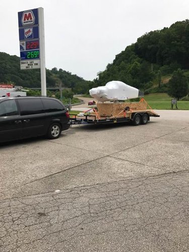

by 9GT
900 mile trip. Didn’t budge an inch. Wings, VS, HS in the wood crate underneath the fuselage. Its my RV-9A.
