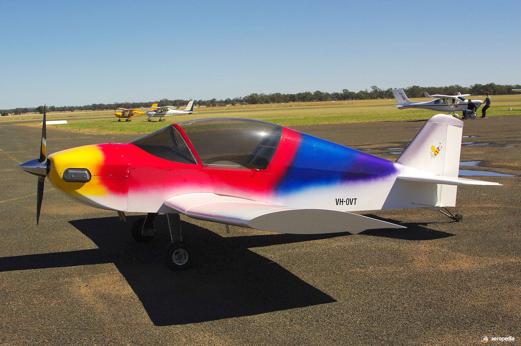

There was a thread on the homebuilt aircraft forum, but they do the paywall thing now so most won’t have access. Someone asked about modifying the canopy for the Onex, and someone else posted the picture I’ll attempt to attach.
I can’t find any other pictures or info. It’s in Australia registered to Simon Pike. Anyone have any additional info?
In my opinion, this is fantastic, and how the plane should have been, mostly because it keeps the fuel filler outside of the cockpit. It would compromise the lifting body effect though, and I wonder how that changed the flying qualities.

I’ve always thought the Sonex should have a steeper windshield like that - partially because it looks a little more like a normal airplane, but also for the exact reason that the gas nozzle is right next to the windshield.
I do think that looks better than stock. And I’m 99% sure the flat bottom of the airplane is what contributes to the “lifting body” - certainly more than the rounded canopy that mostly only directs the air up and over the fuselage down the center of the canopy. The stock windscreen is probably a little more slippery, though.

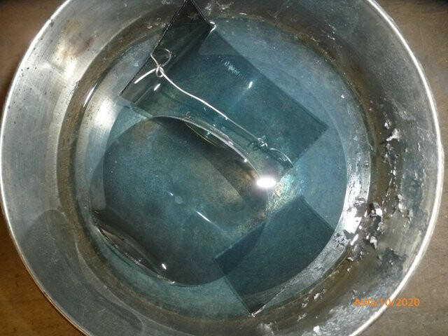

I run 93 octane non-ethanol in the 912 though it could also use 87 octane with 10% ethanol. I’ve suspected that auto fuel is far more damaging to the windscreen and canopy than 100LL. I’ve read plenty of reports of people spilling 100LL, including videos Sonex put out from Oshkosh. I’ve been meaning to try to test that theory (not on my canopy ), and I saved some scrap canopy trimmings to test.

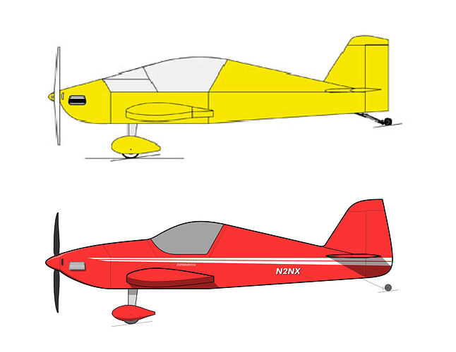

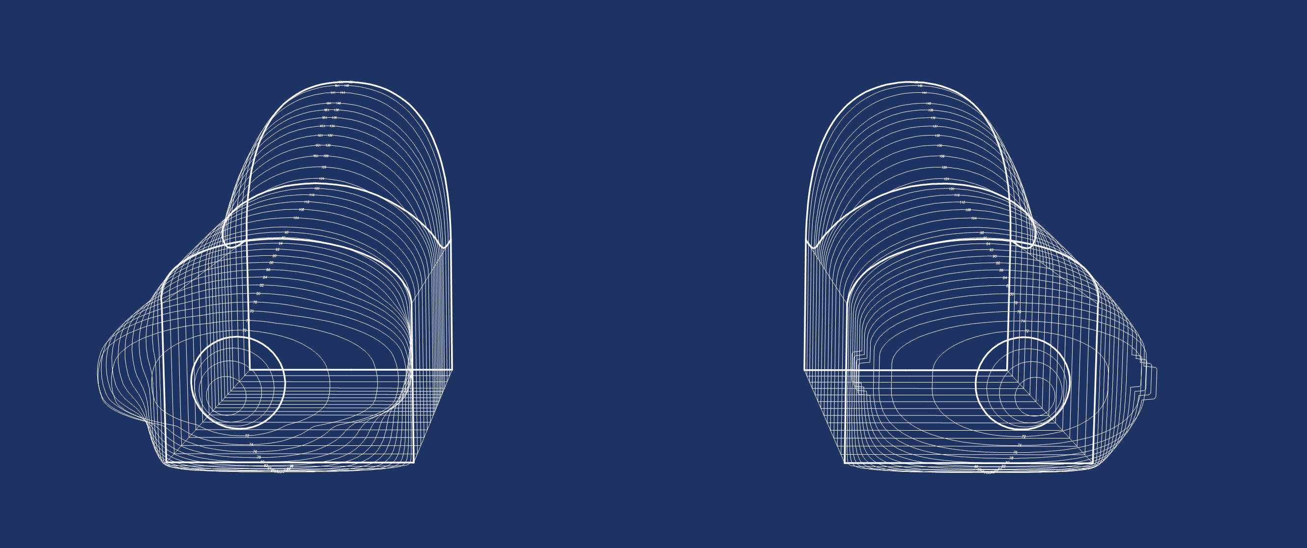

Thanks for posting that here, Rusty; I didn’t think to. For those who aren’t members at HBA, here is what I am working on:

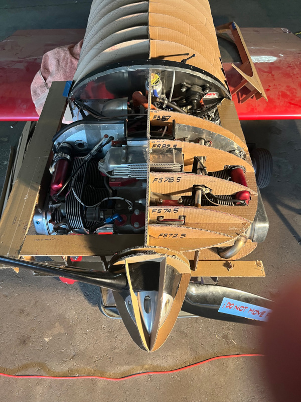

I’ve gone back and forth on including cowl cheeks but right now I’m leaning toward keeping it simpler and leaving the valve covers exposed.
Hopefully this isn’t considered heresy by other Onex fans!
The canopy shape you’re proposing absolutely transforms the plane from ugly duckling to swan (in my opinion of course). When I get the Ruckus flying, I’ll probably take a hard look at fixing the fuel situation once and for all. I’m not really up for making my own canopy, but if I can come up with some way to modify the front using the existing canopy plus a new windscreen, that will be an option.
Rusty
Welcome to the forum! How are you going to make the rudder with that rounded profile?
If you decide to run a test, be sure to stress the Lexan while testing. I did that by safety wiring a piece bent. I tried both avgas (first) and mogas. The stressed piece of lexan crazed with both. But …, maybe avgas is slower to craze. I didn’t test that.
Yeah, any “stress risers” like cut edges or drilled holes are the first to go. I wouldn’t be surprised if stretched surfaces from being bent fall into that same category.
Even without testing, I’m fairly convinced that auto fuel can be much worse than 100LL. Even if it’s OK today, next week they could add some other additive that isn’t OK.

Thanks Bryan. I plan to get it flying with the new canopy before doing anything to the tail. I think the rudder will be composite (likely a CF molded part with perhaps two stiffening ribs to try to keep it as light as possible) but I haven’t made my mind up on anything yet.

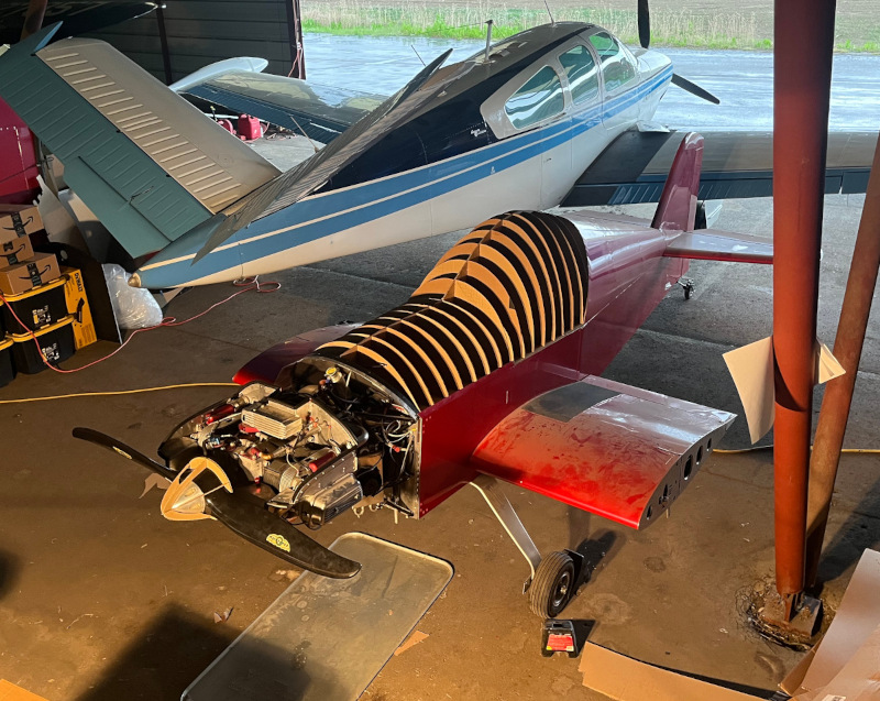

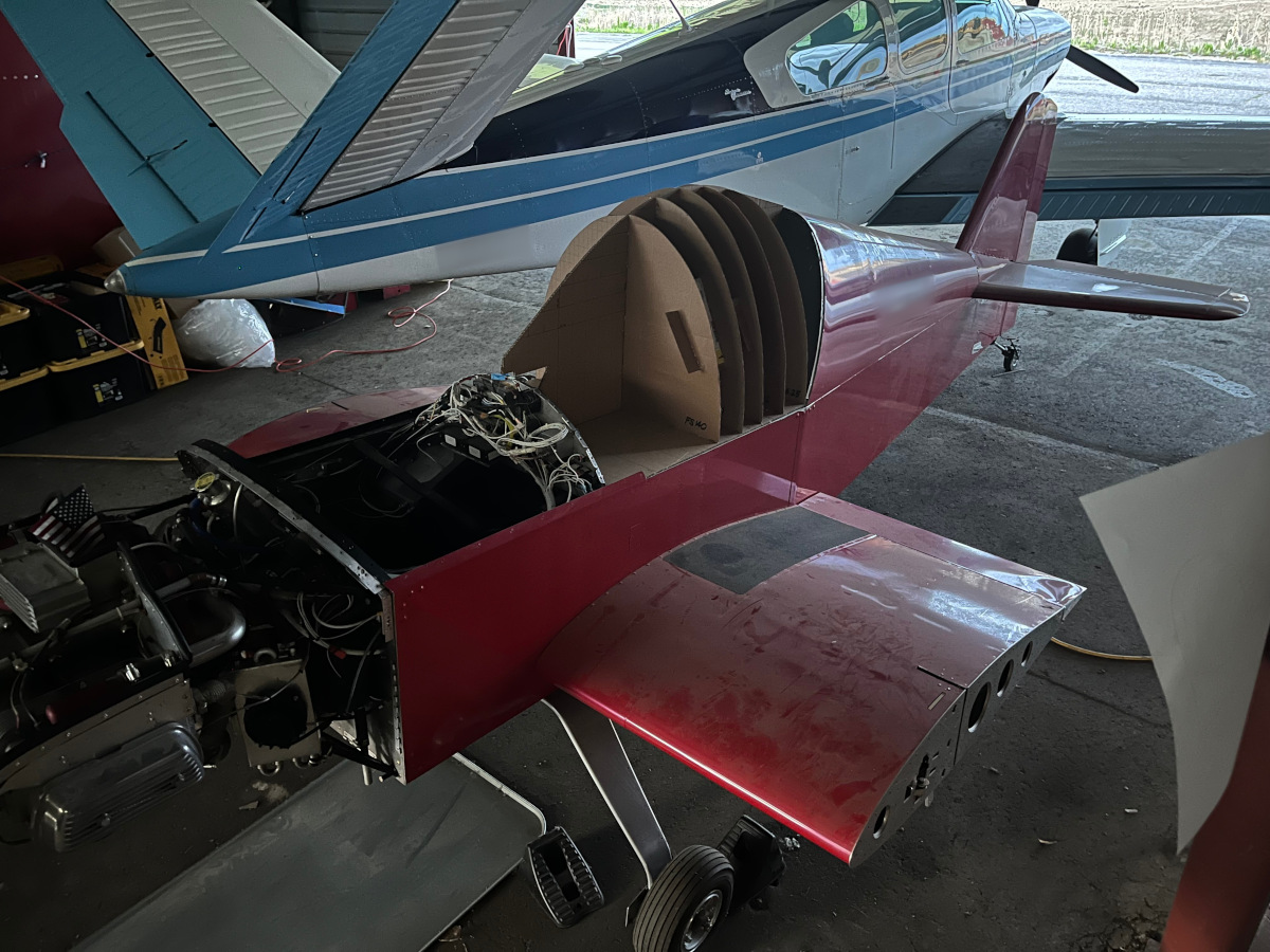

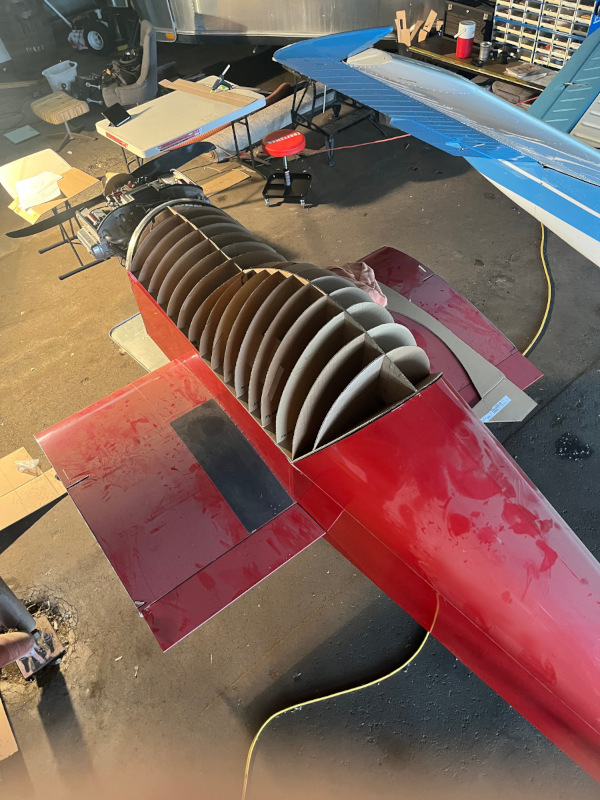

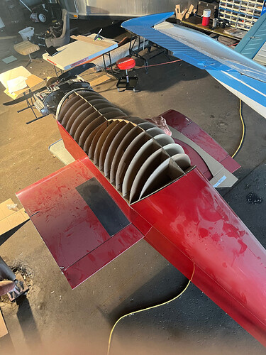

Here’s the current progress. More info here: Onex canopy mod | Page 3 | Homebuilt Aircraft & Kit Plane Forum

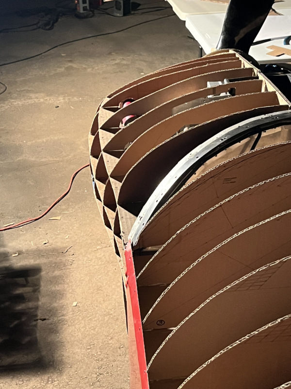

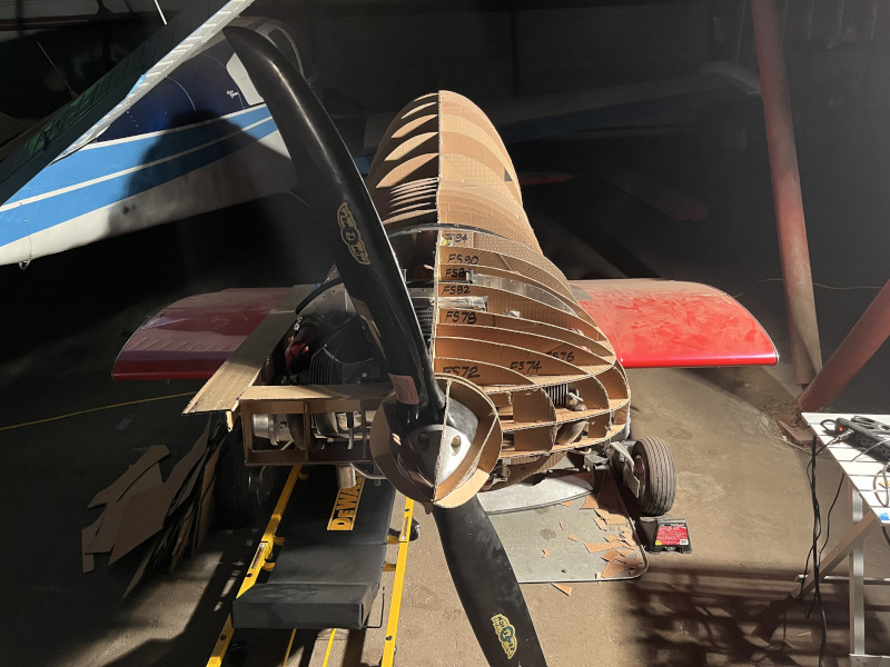

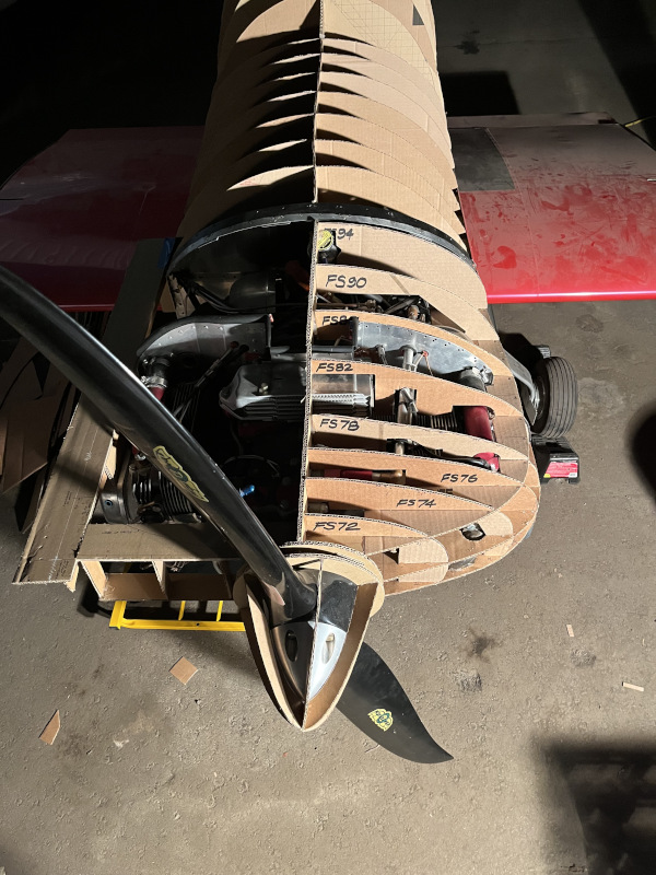

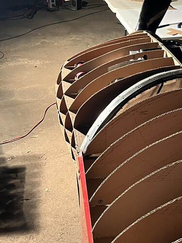

Here are some more progress photos for anyone who’s not on the HBA forum.

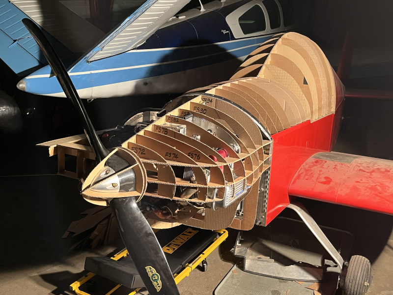

A little more progress to share…
I tried it both ways, and I think it turns out that the cowl cheeks work better.
