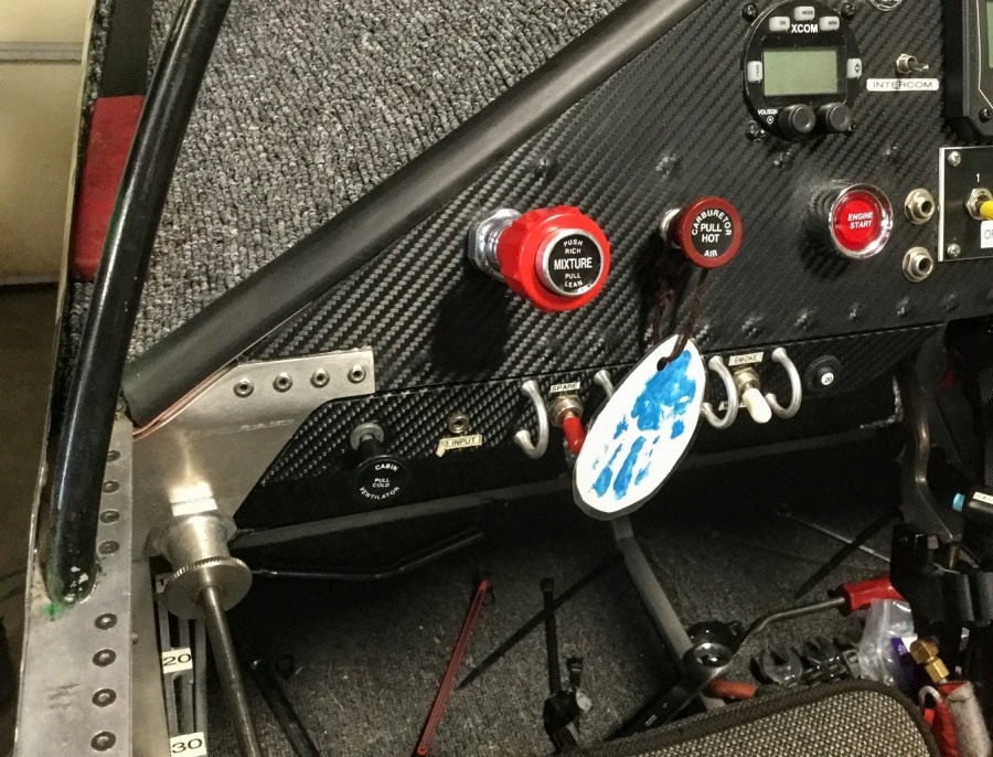

I used the same one as Matt. I measured and selected a custom length. I also made a reversing mechanism that lets me use all of the mixture cable travel. I think I started documenting it on this page:
viewtopic.php?f=39&t=578&start=1000
Here is my mixture control in action:
Now that I’m running the engine and taxiing, I can report that all this stuff actually works.
