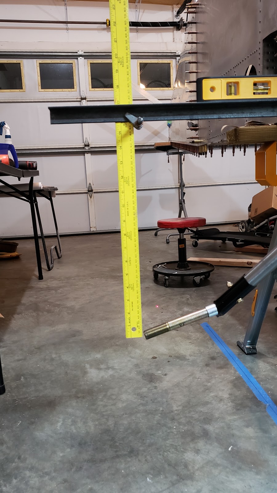

Also, I grabbed a chunk of angle iron and clamped it to the lower longerons to give me something to measure to from the axle. So the wavy garage floor variable is out… Good thinking

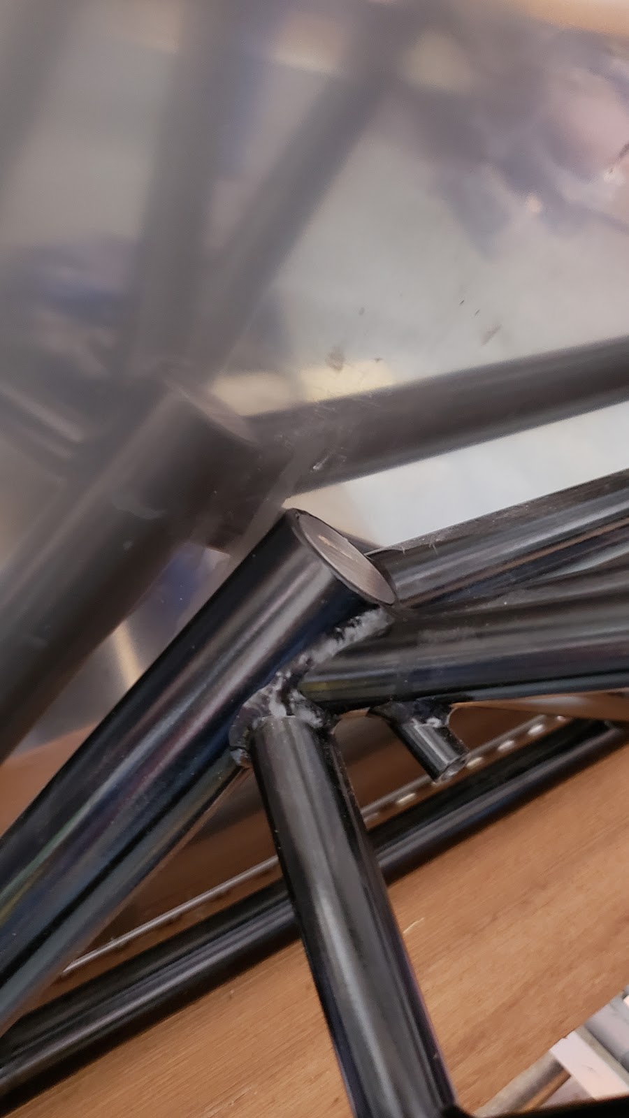

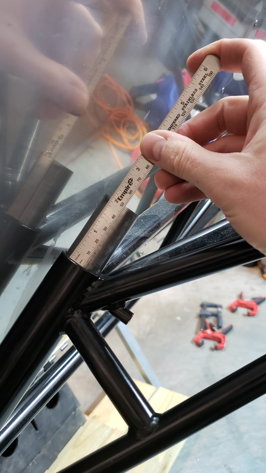

by Spaceman
Dang you guys make a good point, I guess more deck angle would do more good than harm. Maybe I’ll go back to close to flush between the tops of the legs and the engine mount. I tried calling Sonex this morning but they’re closed for a winter storm. I don’t miss living in Wisconsin this time of year!
Anyway, in reference to what I posted last night, here are a couple pictures. There are more on my blog in my signature if you’re really curious. This is how far I had to push the legs up to match the vertical dimension from the floor to the axles that the plans call for:
