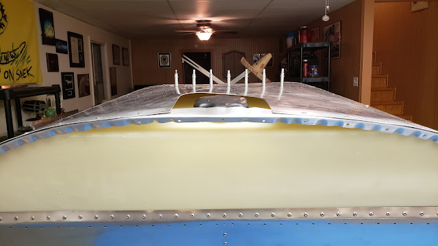

Does anyone else’s glare shield look like this? Everything fits fine, but it’s a bit wonky in the front/center area. I suppose from shipping or sitting around my garage for the last two years it just isn’t quite flat.
I thought that the fuel tank would fit tightly enough against the bottom of the glare shield to force it into the correct shape, but there’s actually like 1/2" of space between them so that didn’t fix it. Perhaps now that I know there will be some room I can rivet a small channel to the underside of the glare shield to give it some rigidity.
Just curious if anyone else ran into the same thing!

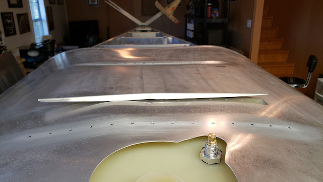

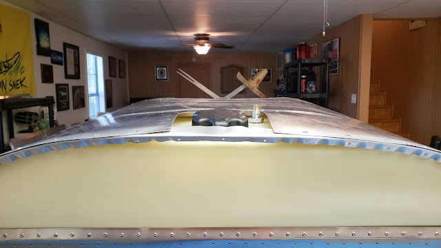

I fixed it! I had an extra tank stop angle in my kit for whatever reason, so I used that as a reinforcement. I had to cut it down quite a bit and taper it so it wouldn’t touch the top of the tank, but I think it made a decent improvement.
Here’s the shape I cut the angle into:
Here’s what the glare shield looks like now with it installed:

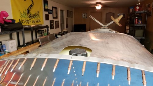

Here’s the before, for comparison:
