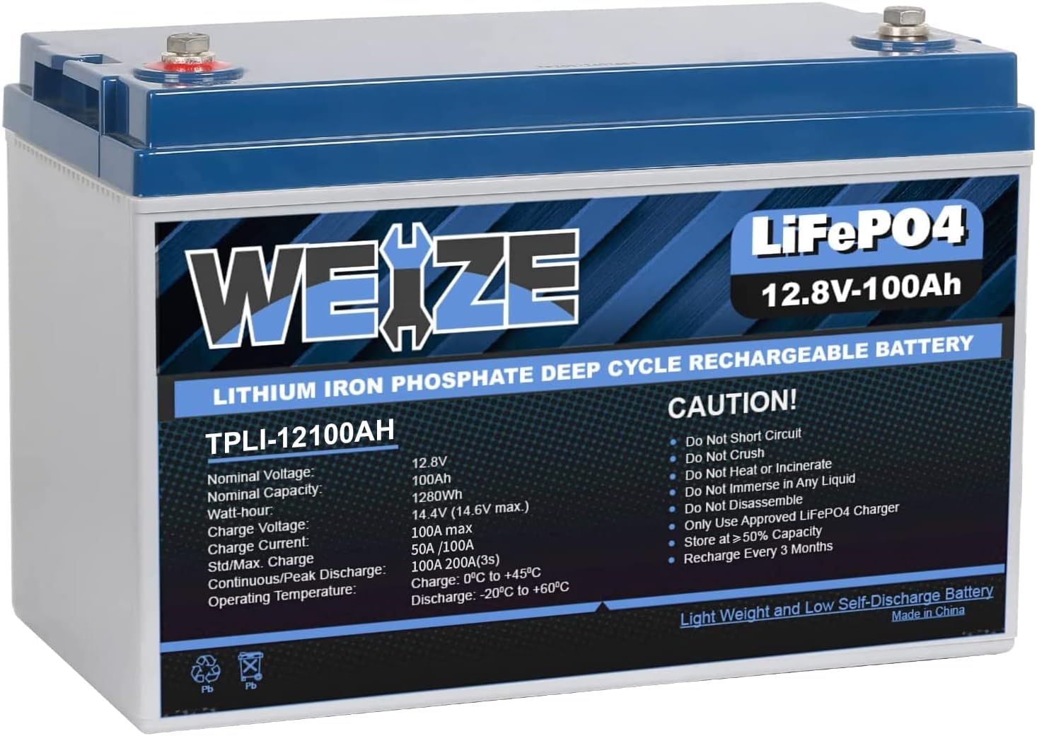

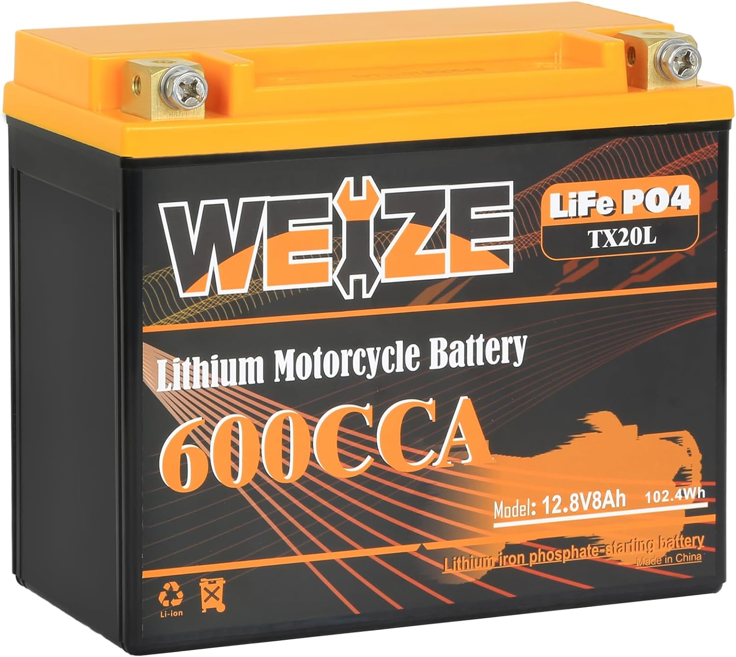

Here is the Weize battery on Amazon:
The Weize is definitely chinesium. Also the EarthX will flash the LED for overtemp.
