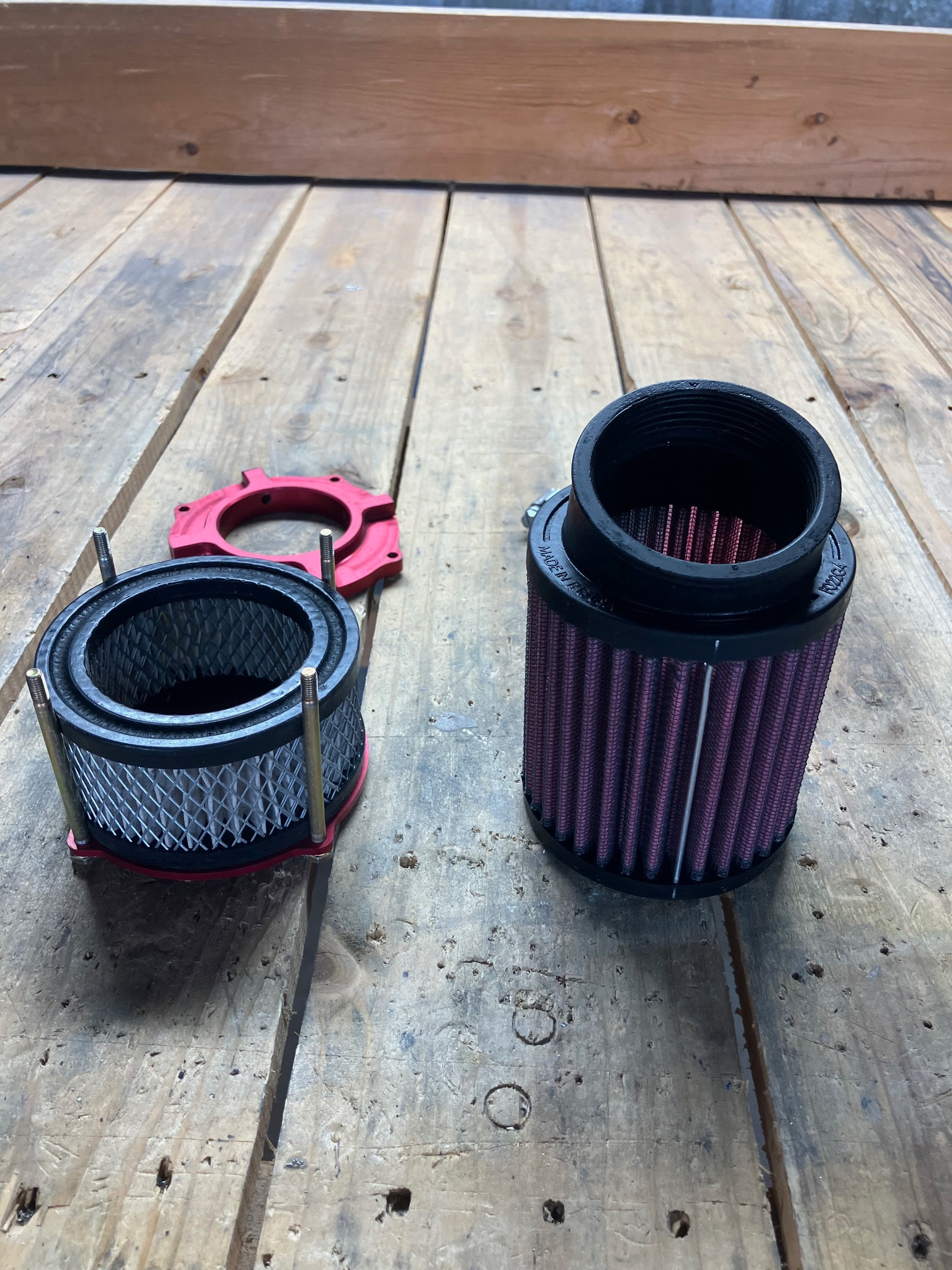

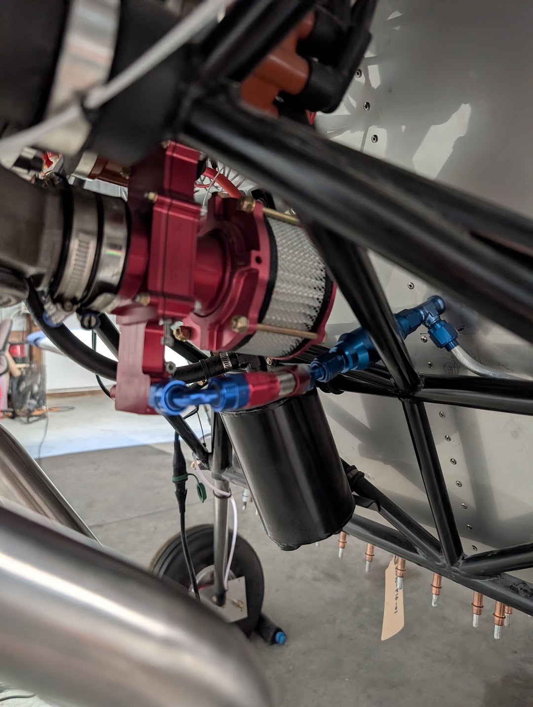

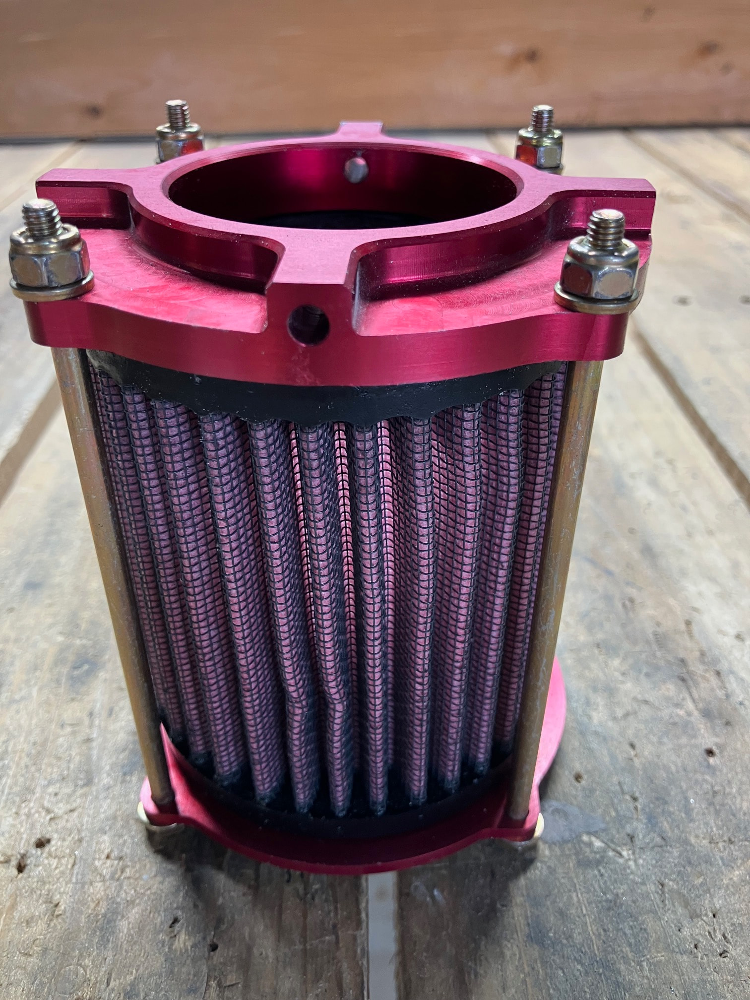

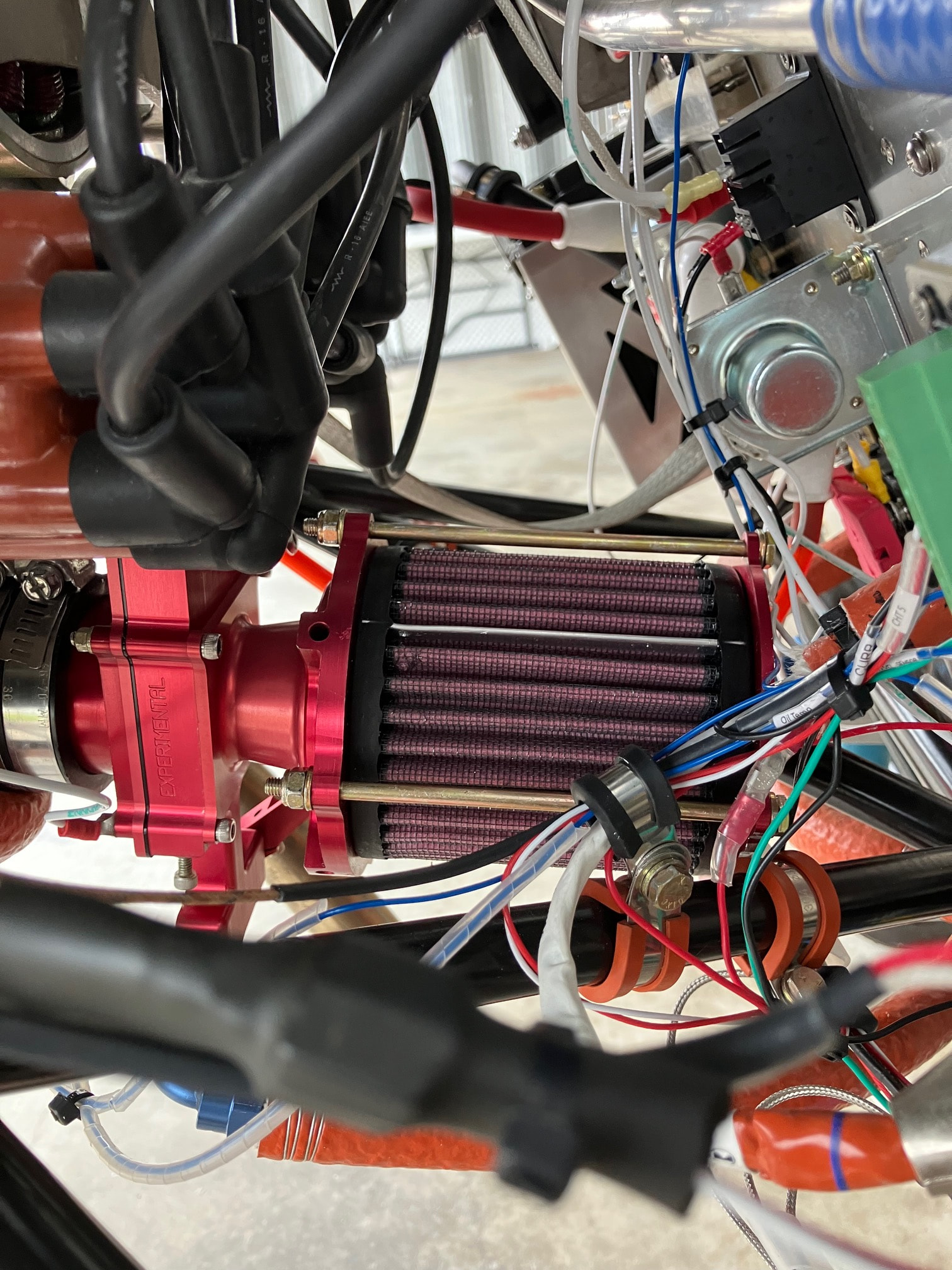

I believe you have a tailwheel aircraft - same as me. So, I used the K&N RU-1700 air filter. The Tricycle gear guys need to use a different solution because their engine mount would not accomodate this air filter.
I used the Sonex air filter end plates and modified the K&N to replace the stock Sonex air filter. The RU-1700 has a 30 degree adapter neck that must be removed - but then fits perfectly into the sonex end plates. Packaging into the engine mount is tight. Hope the pictures help.
