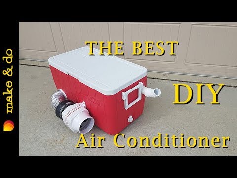

No, not the mighty Corvair engine (it runs very cool in the summer temps) but rather it’s the pilot (me) that is hot. As I get older I dislike the heat even more. I can fly early in the morning but the temps are still > 80ºF and when the canopy closes it becomes an EZ bake oven pretty quick.
So I’ve considered trying a smaller version of something like this:
It could sit in the passenger seat if solo or maybe fit in the luggage compartment. Yes it is additional weight but if I’m solo and cool … I’d be OK with it for the really hot days.
So … what have you done to stay cool in the heat?

For endurance racing we used “Cool Shirts” which are shirts with a water circulation loop that connects using valved disconnects to a cooler filled with ice water and a pump. Both components can be made at home but we found the commercial shirts much nicer. I would think it might be more efficient to cool yourself directly vs cooling circulating air. Though it can get you wet from condensation.
The Igloo cooler solution actually takes the humidity out of the air.
Josh Bardell did a great job fabricating a small cooler into a cooling system like what you have pictured above Dale. From what I remember he chose a cooler small enough to give a few hours of cooling air while only pulling a few amps, and put it in his baggage area. You may be able to do a search and find his old Sonex blog to get info on it!

Dale, here are ideas from what I remember about the one we bought from Sporty’s for the X2 program. Buy yourself a cooler, a little radiator like the one for the turbo cooling system, a little submersible pump, and a fan. Hack two holes in your cooler. One hole will have the radiator mounted under it. On top of that hole put some ducting or something to direct the air to where you want it to go. The submersible pump is on the bottom of the cooler and will pump water through the radiator. The radiator dumps back out into the cooler. Over the other hole mount a fan that blows air into the cooler. It will get back out by going through the radiator and associated ducting, blowing cold air at you. Also the humidity from the cabin air will condense on the radiator and drip back into the cooler. So it not only cools the air, but dries it out as well. It looked like the one in your youtube link did not dehumidify the air. You could also have the fan pull air through the radiator, and the other hole would just be a vent. I can’t remember how Sporty’s did it. You fill the cooler with a bunch of ice and some water on the bottom, to pump through the radiator. That ice bath will stay at 32F until all the ice melts, or at 0C if you happen to fly to Australia.
