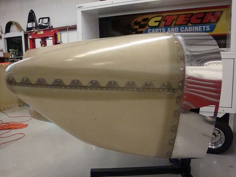

The top cowl was a different story. I could not get the top cowl under the firewall upper lip and in place at the nose without badly scratching the upper rear of the top cowl. So, I decided to change it up. I looked at the way my RV-8 upper cowl was built. My B-model top cowl doesn’t go under the forward upper fuselage lip. I made and riveted a scalloped strip of aluminum to the bottom of the upper fuselage lip, creating a 1-inch “ledge” (?) for the top cowl to rest on. I made the rear of the upper cowl a little shorter and secured it to the lip it rests on using 1/4 turn fasteners. That solved my problem.
I know that description is a little difficult to imagine, but look at how Vans does the cowl on an RV-8. I also used Vans method for attaching the sides of the lower cowl to the forward fuselage. I was able to eliminate the 2 piano wire pins that Sonex has sticking out of the side of the cowl. (hose are fiddly to install and remove). I didn’t like that on my first Waiex and didn’t want to deal with them on this one. Even after my forced landing, it looks better than Sonex’s design.

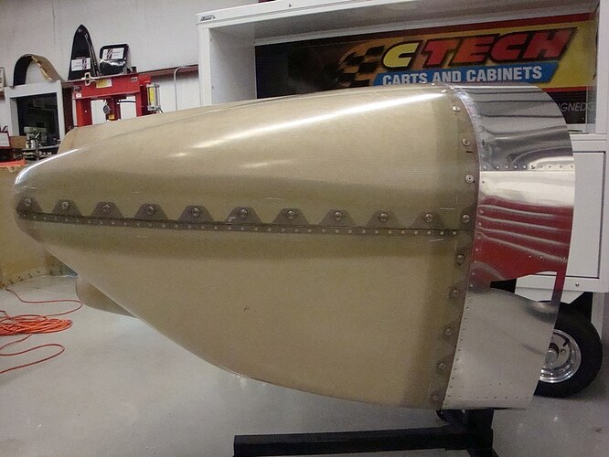

Something like this?

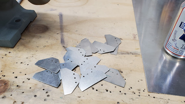

Now that I’m thinking about it, I can probably still do what you’re talking about without too much trouble. I could trace where the windshield skirt ends onto the cowl, cut the aft ~3/4" off of the cowl along that line, then rivet a strip along the bottom of the skirt, and then the cowl should sit on top of that.
I just already have all my Skybolt fasteners already set up, so I will have to try and drill out and reuse all the receptacles that I have on the aft edge of the cowl and move them to the new strip. I hope I can reuse them because I don’t feel like waiting for more parts!!!

Chris,
That picture is exactly what I am talking about. It was easy to do and I didn’t scratch any paint during install or removal. I used hinge pins on the sides and bottom of the Waiex, but on the RV-8 I did it exactly like your photo shows. Really easy and fast. You will be glad you did it that way.

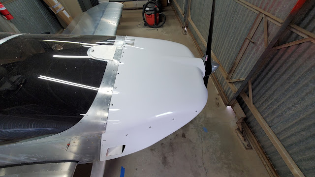

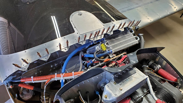

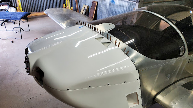

Lou I did what you recommended! It took a few days of messing around but now I can get the upper cowl on and off pretty easily without mangling the prop.
My only issue now is these little gaps in the corners. Now that I’ve moved the aft edge of the cowl a little bit there seems to be no way to make it follow the contour of the windshield skirt all the way to each end… All I can think to do is add some fiberglass or filler to the top of the cowl to just blend it into the skirt a little better. But the gaps aren’t that big; I will deal with it later!
