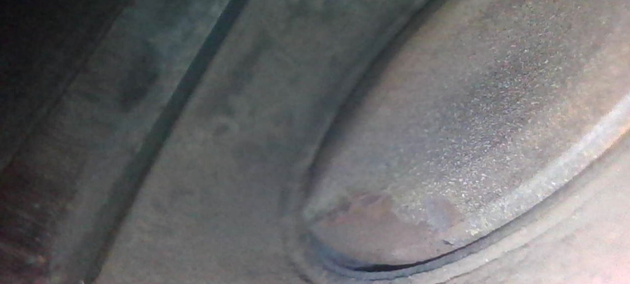

Here is one of those burned valves, 13/80.

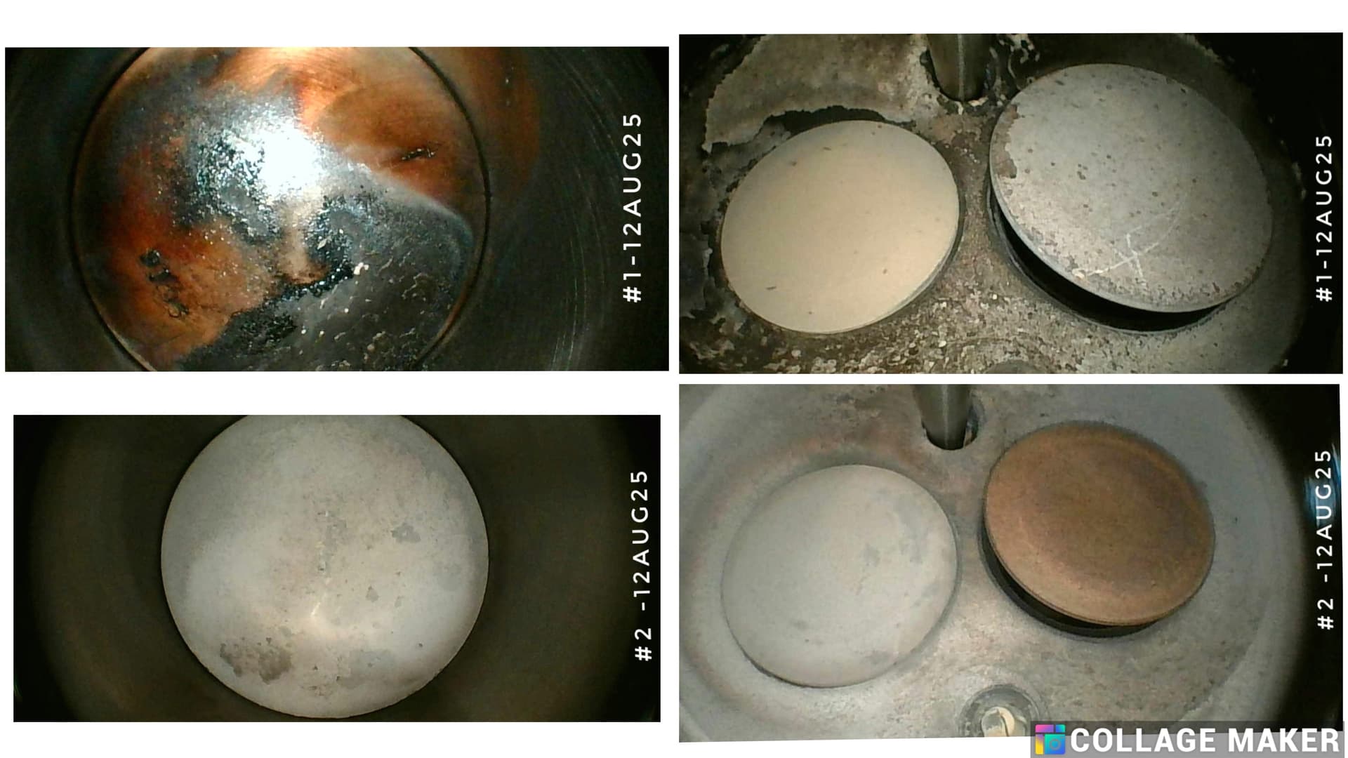

I’ll borescope today. Thanks for your input(s).
Well, here is an update. The valves mostly seemed fine but cylinder #1 is rather unhealty. Cyl 2-3-4 all look about the same as each other. Does this look like preignition/detonation? Clearly not burning properly.
I’m not convinced #1 is unhealthy, but they all burn differently because of different mixtures and different CHTs. It’s hard to tell but the #1 intake seat does look a little hokey. Typically my heads and valves look pretty gunky, I think that is part of the problem of running 100LL but being limited to the temperatures that are OK for the VW. There is a nice uniform color on both exhaust valves, so no signs of burning. Nor do you have the big gap like in the picture I showed before. Going back to what Dale said, I bet if you pulled the heads and lapped the valves your numbers would improve.
