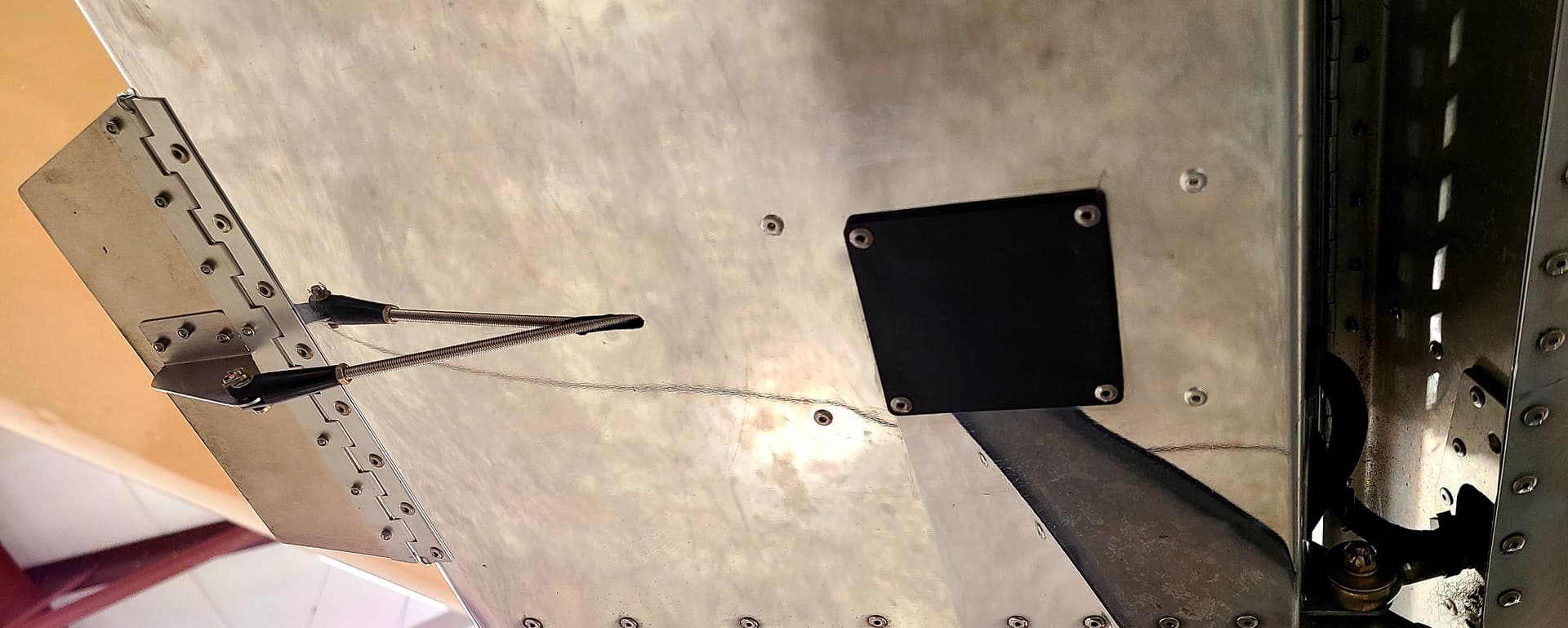

Hate to rain on the parade of elegant trim designs but mine has worked fantastic for almost 15 years now. On my Waiex I’ve always had a very slow fade to the right, hands off, single pilot. Two up it’s more noticeable. After confirming my rigging was correct and adjusting the right flap 1-1/2 turns I did as follows. I cut a piece of .020 sheet 4” long and 2-1/2” wide. On the long edge bent it 15 degrees at the 1-1/2” point. I placed two pieces of Velcro 3/4” wide parallel on the 1-1/2” side. I placed the tab approximately 1/2” forward of the trailing edge on the left aileron on the bottom side to “fly” the left aileron up. This has been installed now 14 years and plane flys hands off in smooth air indefinitely. I use about 10 degrees or less of rudder trim ( Sonex tab) bent left to fly rudder right and ball centers perfect at 120 kt cruise. Feet on the floor. I’m asked about testing. Yes, it’s been thoroughly tested. My plane has been flown up to VNE over two dozen times and 212mph by accident and absolutely 0 indication of impending flutter. That’s good! No, it’s never come loose and unless one lays under left wing no one ever knows it’s there.

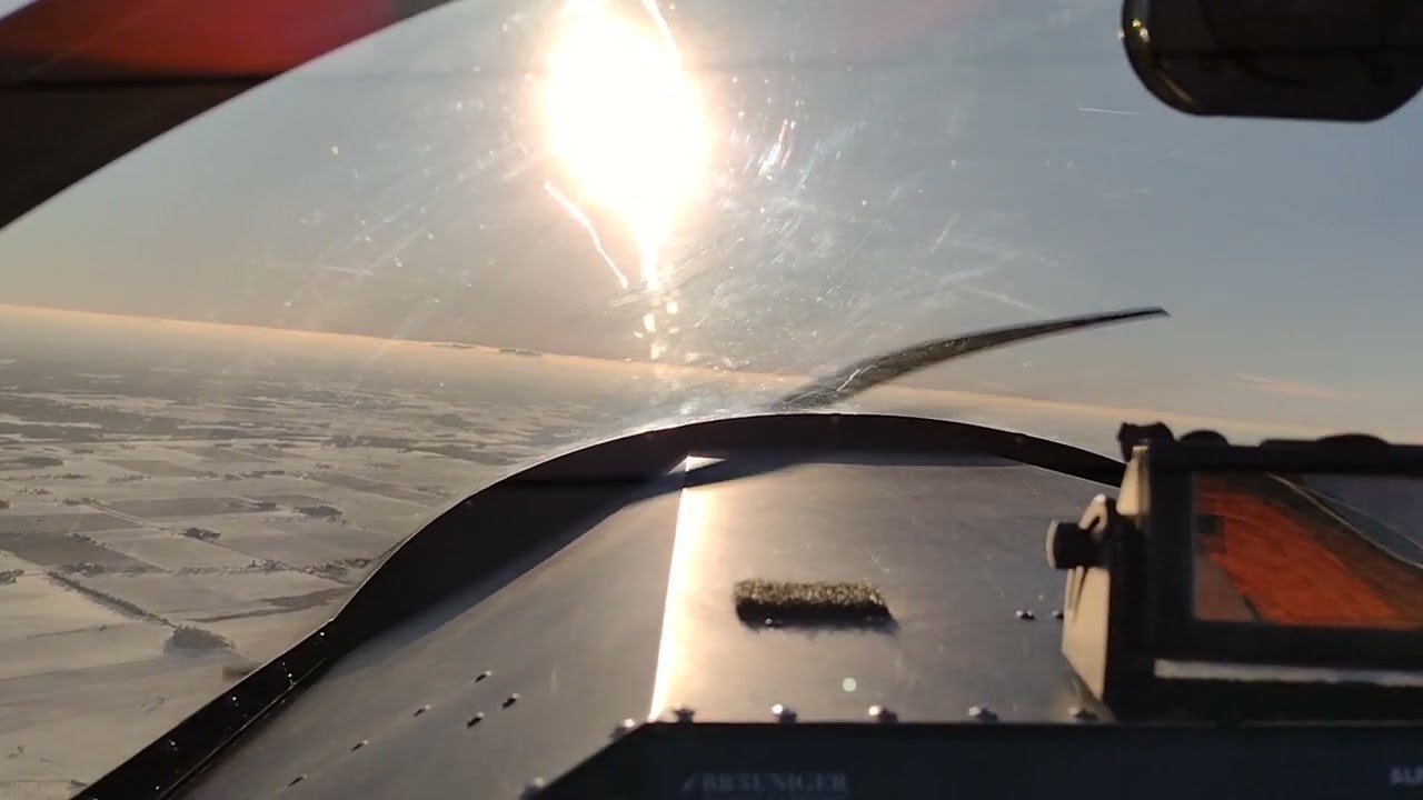

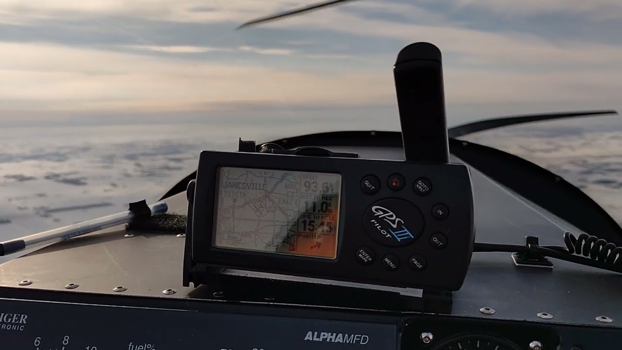

Here are a couple videos showing hands off in either seat.
It’s sort of fun to get them both playing at once so you can compare rates.
