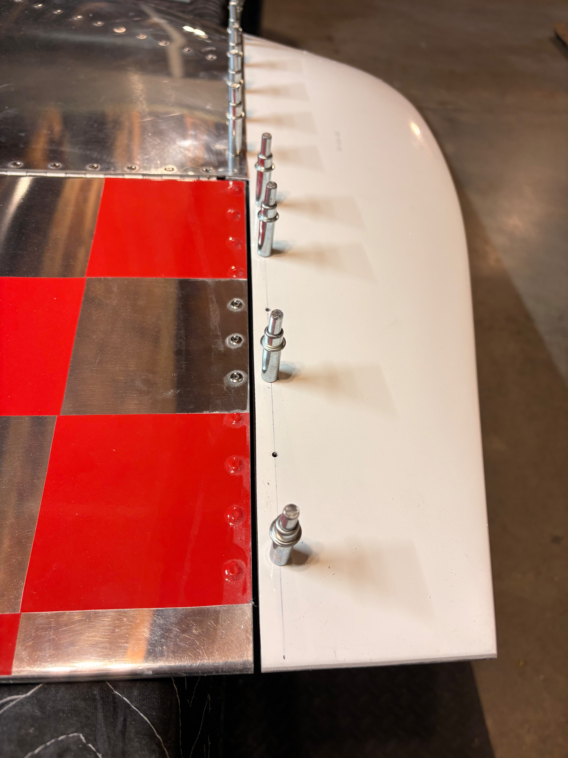

I received the backordered tips a week or so ago. Then got the revised horizontal tip ribs yesterday. The vertical stab tip was cut and installed this weekend. Tedious cutting and fitting. Surprisingly, took me all day. But I like the fit. I think I’m going to try to paint these off the stab then rivet them in place. If I can get them re-installed without scratching the visible paint Hopefully the horizontal tips will go a bit faster now that I’ve done this once.

My question is about drawing SHX-H01 Horizontal Tail Assembly. Maybe I’m going blind, but I don’t find on the drawing where it tells you specifically to drill the hinge using the #40 holes in the tail skin, then updrill, cleco, deburr, and rivet. Detail C talks about positioning the hinge, but not actually attaching. There are 140 CCP-42 rivets specified in the parts listed so they must want us to attach but it doesn’t actually say that.
Also, I was surprised, looking at section B-B that the hinge attaches to the bottom of the bracket. I was expecting the hinge to go between the tail skin and the bracket. I guess the thicker (stronger) metal in the hinge is why they put the hinge under the bracket.
Another thing, I’d mentioned that I screwed up one of the elevators by cutting the angle for the elevator horn too deep. The result came out OK but the elevator is 5/16” shorter than it should be. At first I was going to split the difference so each side is only off a little when lined up with the edge of the tail skin. But thinking about it, that moves the elevator horn off center. So I’m thinking the good elevator should line up properly with the edge of the tail skin, which centers the horn, and I’ll just work the tip on the other side as best I can for looks. Does that make sense?

No hard feelings here business is business, in this industry if someone thought you were going under it will kill confidence and nobody would buy, Mark had to try his best all the way to the end trying to save the business. I also don’t believe he knew until the bank called it. He did not set out to screw anybody, he was trying to work on getting the product out that would hopefully carry the company on. Nobody likes to lose money but I only put out in deposit what I was willing to lose. It was in the back of my head as we have all seen it before in this industry. I’m out the fuselage deposit, I think 7K, not as bad as many others like yourself.
Yes, the hinge goes below inside the channel like you said. I at first also assumed it would go in between, it does not. A good rule about riveting I have heard is to not do so until you need to. Sounds like you are there. Yes, the fiberglass tip will have some fudge factor to blend in your 5/16 I believe. I write that thinking now that it wont be a flying part. If it was flying I’d probably remake it if it were me and hold off on hinging until the new elevator was made.
But as we’re all going for hangar decorations at this point, it will be fine. I too will finish mine, probably paint the tips still too. Then hang it. I learned and enjoyed the tail build it was worth its cost in that but I do wish I had that 7,500 back to put toward buying a flying aircraft.
