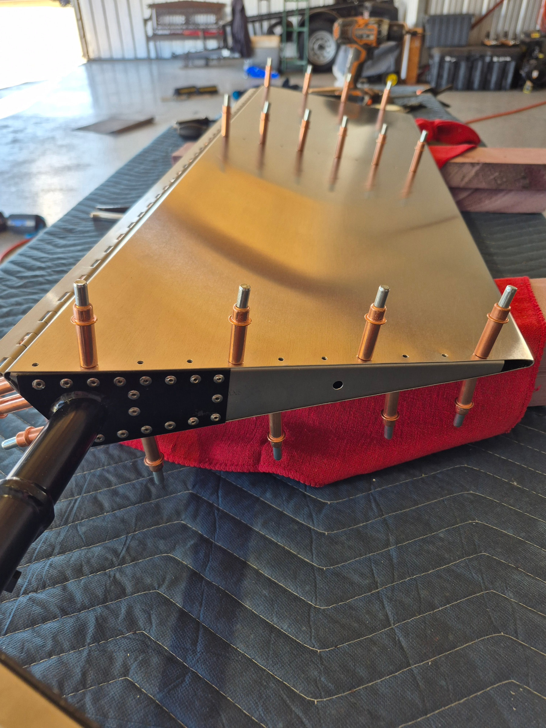

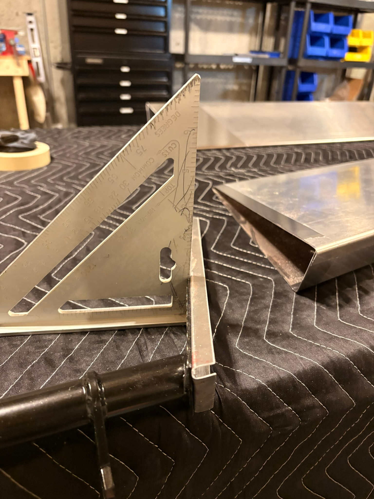

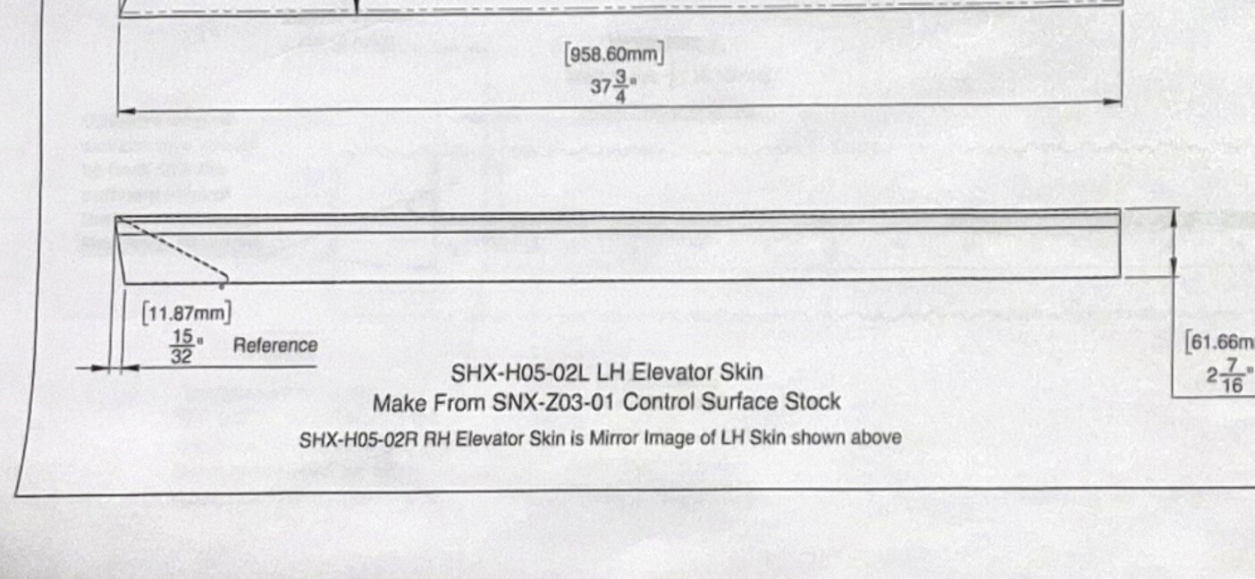

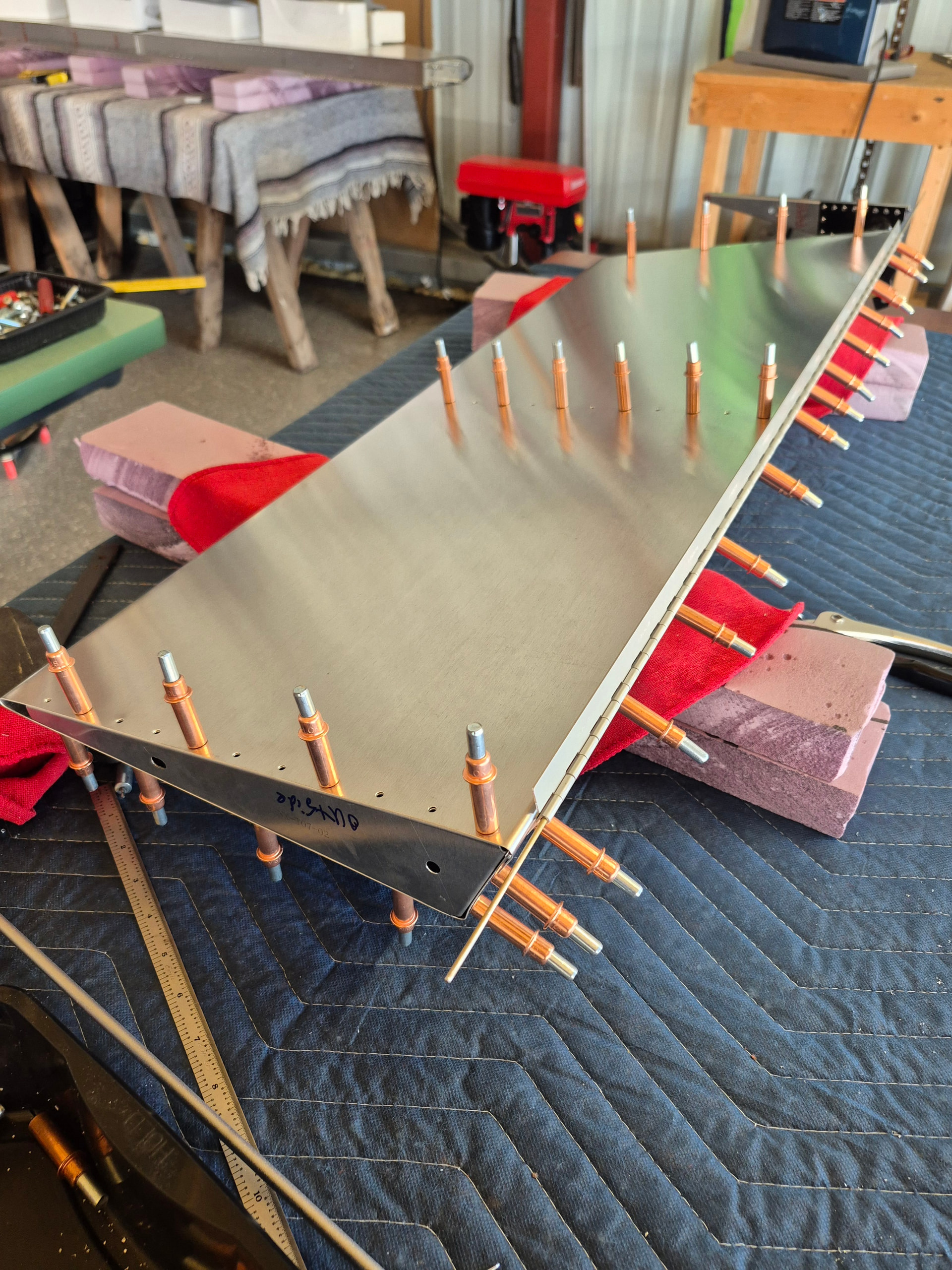

Made a little more progress. Completed the horizontal stabilizer and right elevator. I had a little trouble with the elevator. The 15/32” (suggested) cut was the problem. The idea is to make the elevator match the elevator horn which angles to the inside on the bottom of the horn/elevator. I attempted to start with the 15/32” cut, but that proved too large and I had to work the elevator by removing/sanding on the top edge of the elevator to get the horn to match the elevator. I think it worked out ok. See pic. That is such a critical angle on that part. I wish that the Sonex computer aided machines would have made that cut and sent the part with that angle already done.
Stabilizer
Elevator
Well done! Anybody can do it right the first time. It takes real skill to fix a screwup. Speaking from experience here…
Note that 15/32” is a “reference” measurement not a cut instruction on the plan. Just the angle of the root skin cut from leading edge to trailing edge helps produce some of that perceived angle. The root rib is actually pretty square.
Impressive recovery. Perhaps a good reason to cut the root before cutting final length.
For other builders reading this…This step came up when I picked up my tail kit and Mark gave the following advice. Cut the elevator skin root as a square cut top and bottom (the 4-3/8” trailing edge measurement on the plans) then fit the rib and mark the leading-edge angle that is remaining to be trimmed. The trimmed portion also tapers off as you go aft.

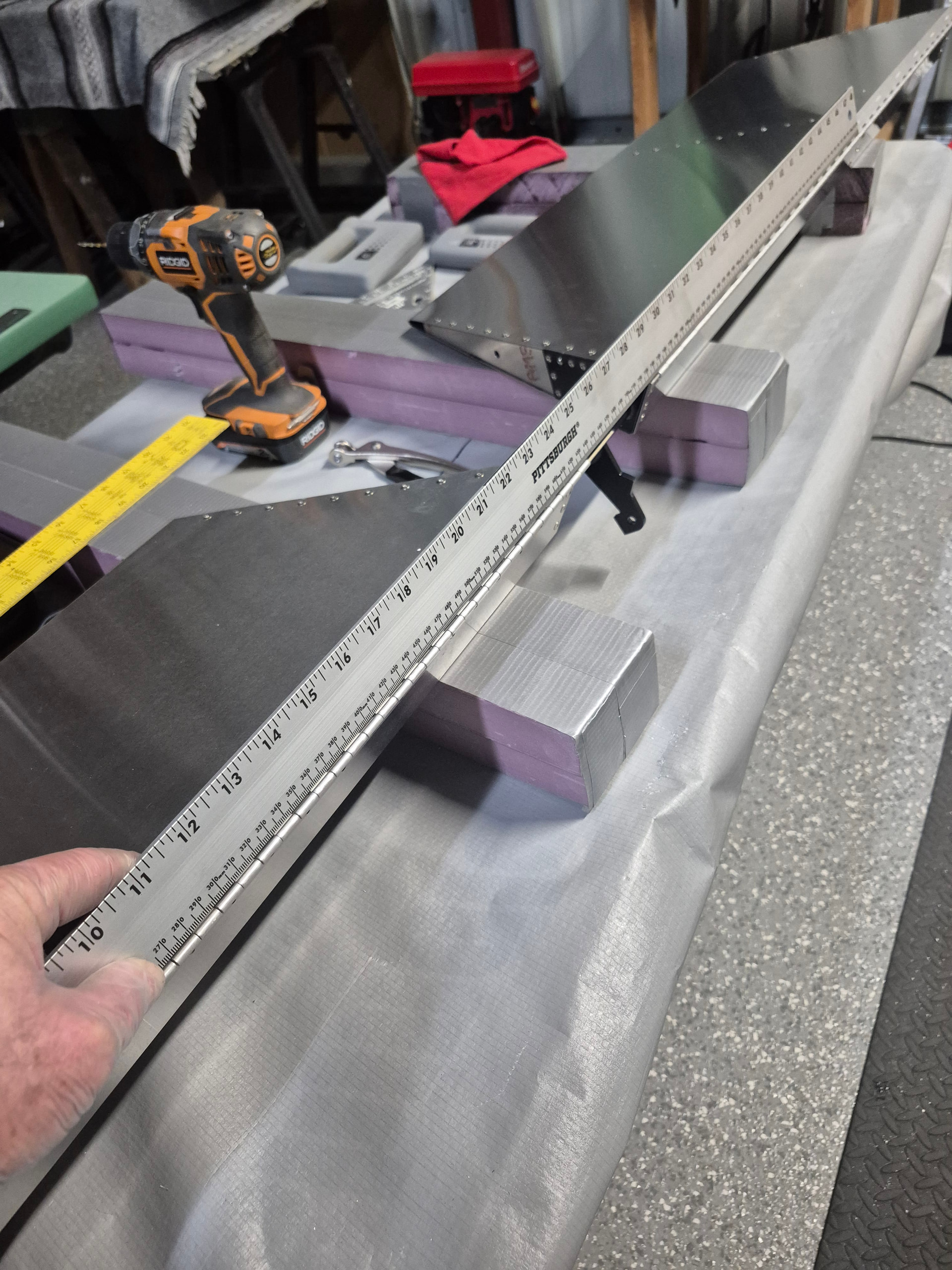

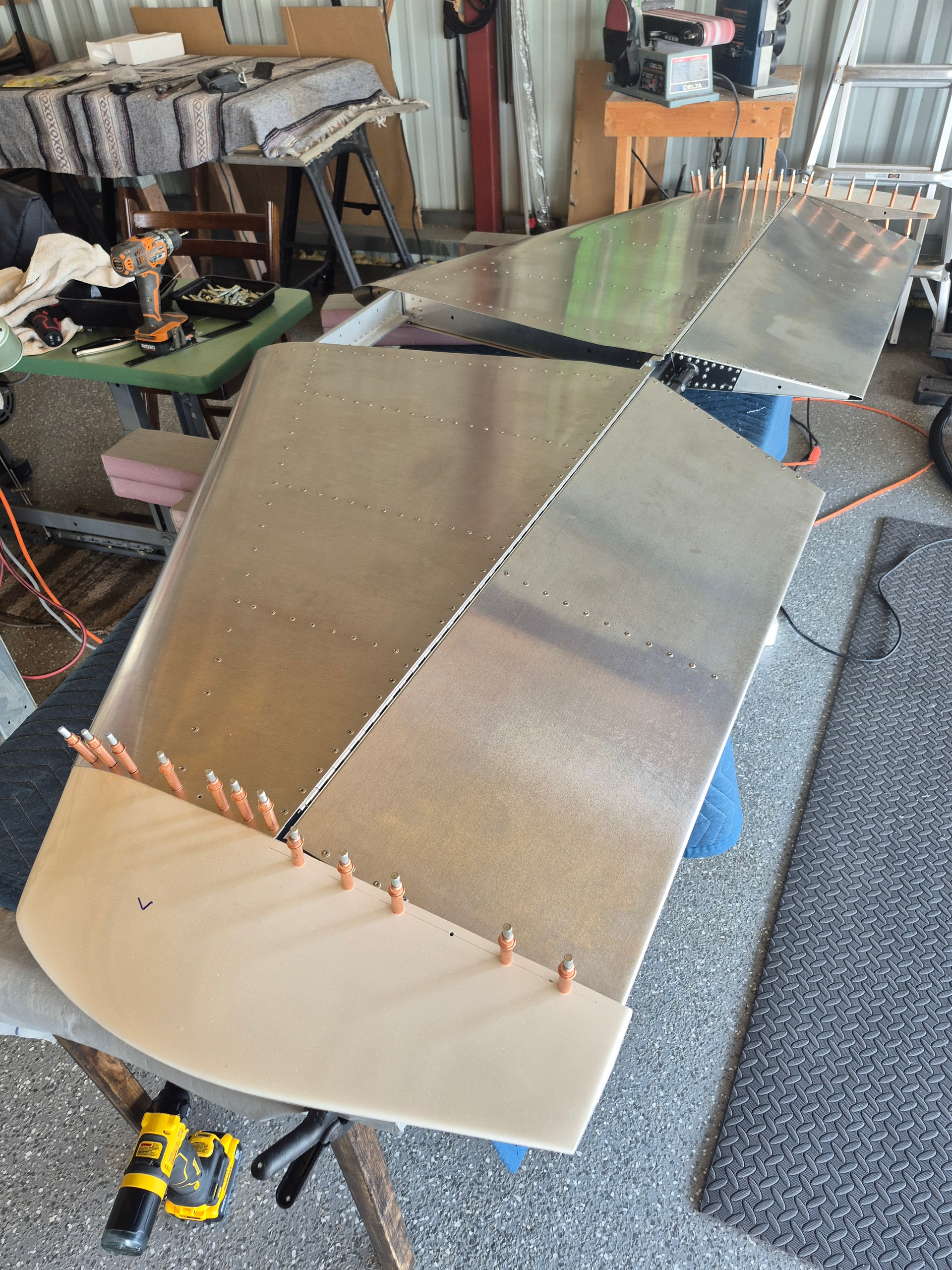

So what the heck. With all the bad news, I finished my HW elevators today. Turned out well after my rough start overcutting the angle that matches to the lower side of the elevator horn. Not that I’ll ever be able to use them, but some satisfaction from completing the task. I used the 48” metal ruler to help insure the hinge line was straight.

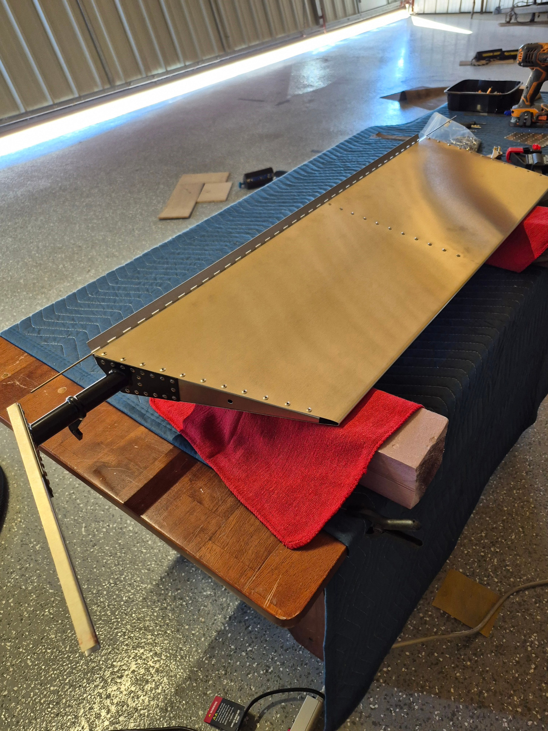

I have continued with my tail build. Pretty near being done. I finished the rudder and vertical tail (except that I have not riveted the tip on top - I plan to make that a removeable tip to mount a position light). I attached the elevators to the horizontal tail. I also installed the tips although I have not riveted them yet. Getting nearly done with the tail. Excited about moving forward with the full kit.

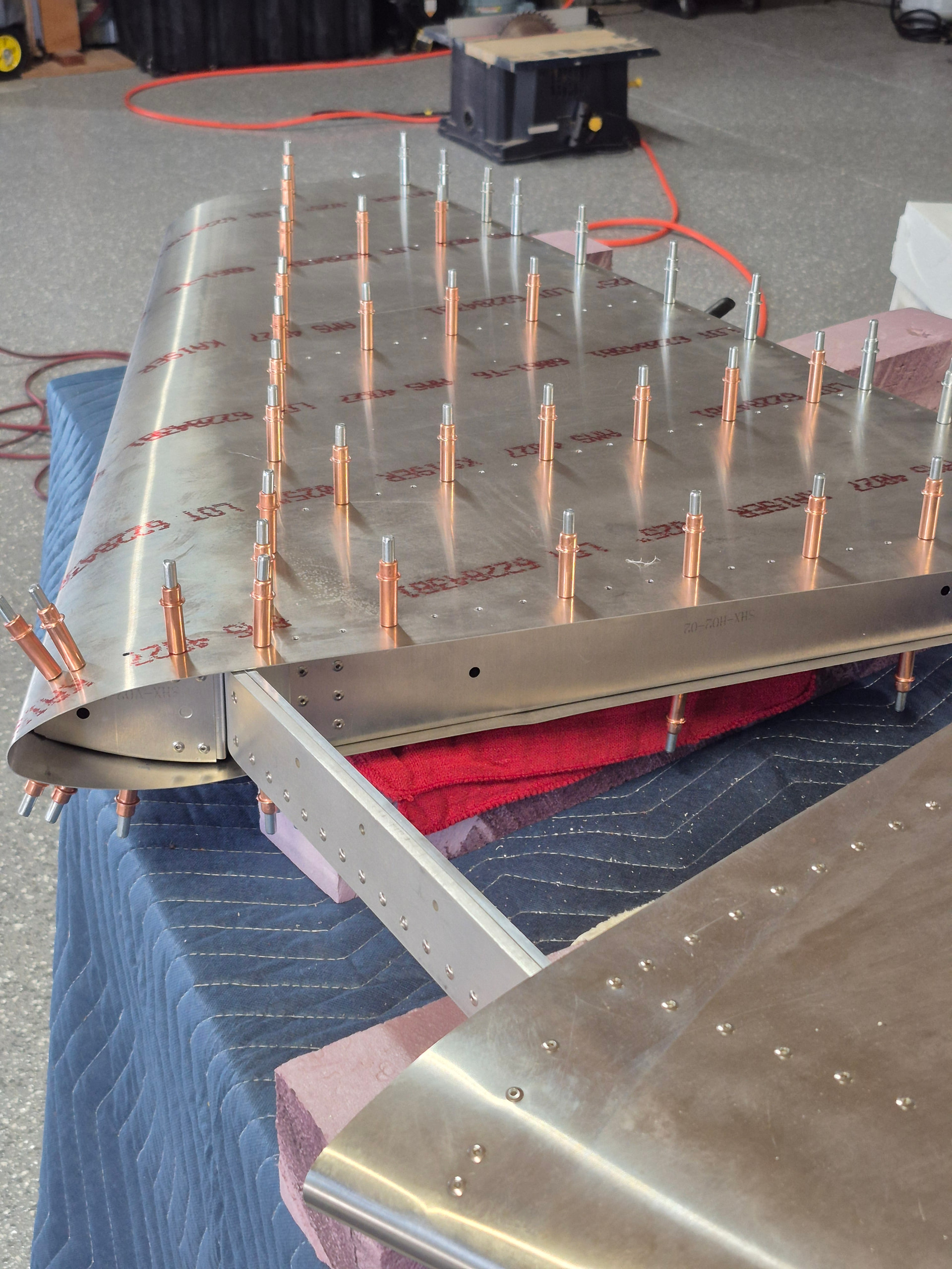

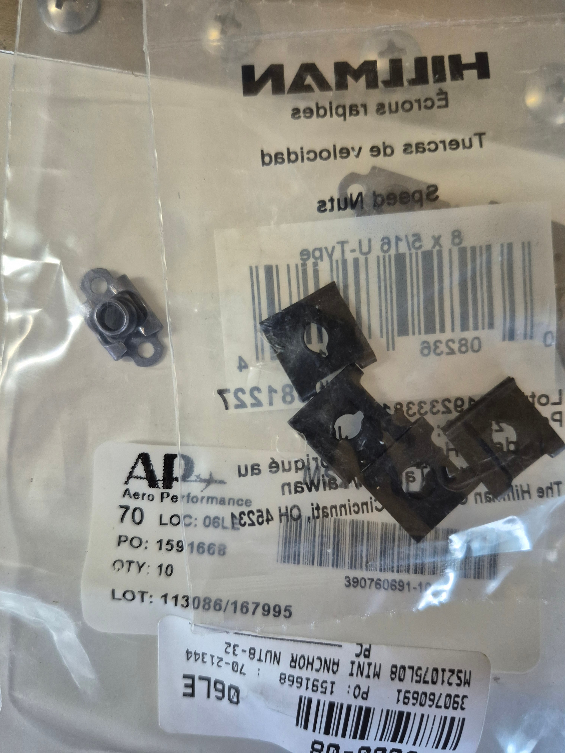

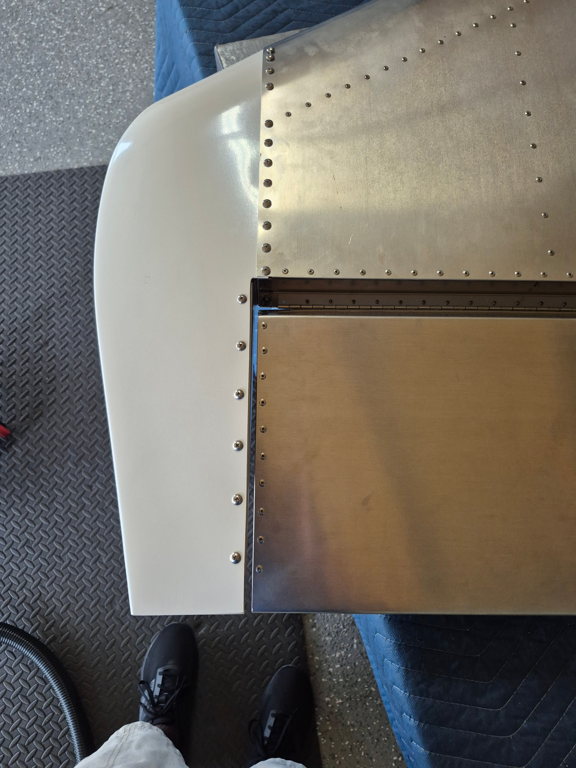

Finished the horizontal tail / rudder tip. Made it removeable so I can go back later and install lighting. Installed nut plates on the forward rib tip and slip on screw plates on the aft rib tip. Turned out decently.

Nice! The tips were the only real tedious part of the tail build. Lots of on/off trim and fit, trim and fit.
Thanks Chris. The “removeable” feature was a fair amount of work. The nut plates on the forward facing rib were pretty straight forward to install except for the holes near the front where the rib is fluted. The curvy part of the rib made the nut plates pretty challenging.
Sometimes 1-legged nutplates can make this easier. You would need enough depth from the edge to mount them though.
I used “mini” floating nut plates, they’re probably a bit over 1/2" end to end. I did have to turn them diagonally to get the hole to sit relatively flush with the rib where the rib is fluted. I think the floating feature of the nut plate where the female threads are, was helpful with allowing the machine screw to go in. When I was looking at nut plates I did not see the one-legged nut plate. That might have worked too.
I also considered rivet nuts. They might work, but I was concerned with the top flange of the nut making it difficult to get the fiberglass tip to slide in.
I’ll check out the one-legged nut plates. Probably won’t be the last time nut plates are needed on the build. Thanks for the ideas Bryan.
