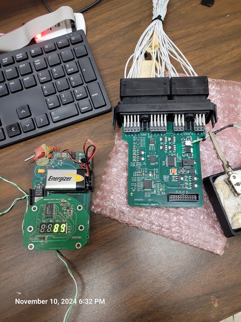

I’ve used thermally conductive adhesive to measure the temperature of various electronic components. Ref. Silicone Thermal Conductive Adhesive. When cured the adhesive is much the same as RTV.
You can make a TC by just stripping some TC wire and twisting the two wires tightly together. When measuring component temperature, I clip all but one strand of the TC wire before twisting so the response time will be fast and so that the TC wire won’t heat sink the component under test. If you use that method, make sure that all of the twist is buried in the adhesive. The wires can’t touch outside the adhesive.
