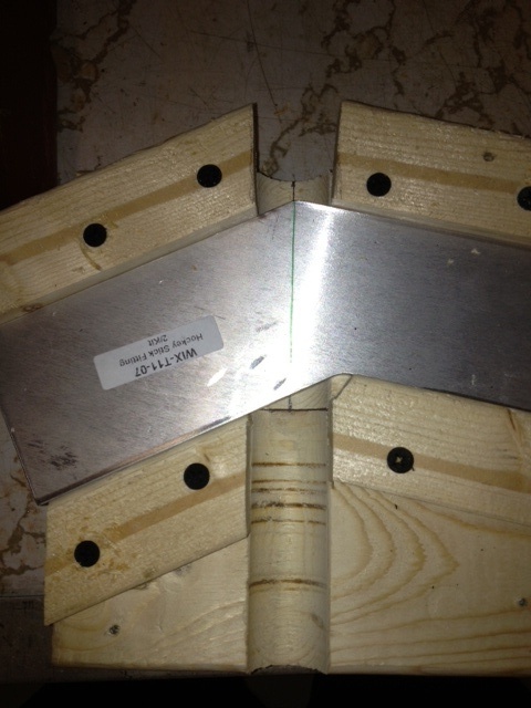

I bent the thick rear stabilator spar cap hockey sticks to exactly 14.3 degrees. However, there is a .5 degree twist between the bend. My arbor press shifted during the bend. Questions:
  1. is this OK to use, as-is? Would this make the stabilator angle of attack .5 degrees off?
  2. Shall I twist it back with a vice and mandrel?
    World this small tweak work-harden the bend too much and make it brittle?
  3. Shall I re-order and re-bend?

Twist it back. That much is not a big deal and it won’t hurt the material.

To prevent the hockey sticks from twisting, I screwed down 4 pieces of wood. Worked great.
This was from the first page of my thread.
viewtopic.php?f=39&t=578
I made a total of 3 hockey sticks.
If I understand your issue, that might be hard to bend back. But I did some tweaks after to make it perfect as I could.

I bent my hockey sticks with utmost care and best precision I could muster. When it came time to install the tail surfaces I was quite dismayed, they did not mate up well at all. I fabricated tapered shims out of scrap 6061 t6 and used longer bolts for the extra thickness of the shims. She flies straight!!

I too bent my hockey sticks to precision but when I went to install them I still had to tweek them as they didn’t mate up at all. Maybe just get them close and tweek some more as needed.
