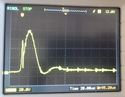

I prefer to run a shielded wire between the Magnetron and the ignition switch. The shielding simply connects to one of the mounting screws which should have a pretty solid connection to the body of the Magnetron. The center conductor connects to the P-Lead tab. At the other end, the shielding and center conductor connects to two of the terminals on the switch.
This way you have a well-defined circuit between the switch and the Magnetron and don’t have to rely on other grounds and potentially sketchy connections. There’s no reason you need a real “ground”–the Magnetron is disabled by simply connecting between the P-Lead tab and its own metal body.
The main benefit to using a shielded wire is you reduce the likelihood of interference from the P-Lead. When the ignition is on, a 90v signal with high frequency components rides on the wire as a potential interference source. Best to contain it within a shielded wire. You probably can’t completely overcome all interference since our high voltage ignition wires are also not shielded, but at least they aren’t running through the firewall with all your other wires.
Here’s what it looks like, notice the vertical scale is in 20v increments.
Oscilloscope capture of p-lead voltage

All above is very true, but one thing is missing about grounding the coils. the plug HV has to have a good ground return to get a nice blue, hot spark at the plug gap. Guess where the HV return path is…on the coil frame mounted to the anodized case. The little ground lug refured to is pretty important, IMHO, to be able to get reliable, hot spark. The ‘button’ refurred to for magnatron grounding is solderable, and I wrapped a large wire…16 ga?..wire around and soldered it to the button, and, of course, the other end was luged to fit under a good size case bolt, with toothed washers fo give 'bite ’ into the metal, and keep it tight too. You should get a nice hot plug spark, and since the mag is securely grounded to the massive grounding system for the engine itself, it would also inhance noise reduction from the ignition system by removing the anodized ‘semi-grounding’ aluded to.
PS: I loved the waveform capture! great job on that!!
