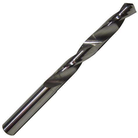

Quickest way to break a Sonex canopy? 8~)
Seriously … if you have nothing else available, use the seat belt buckle to break the canopy. In most accidents of Sonex aircraft that I’m aware of that have resulted in the aircraft being overturned, the canopy was already trashed. Only problem was getting it out of the way to exit without getting cut …

Yeah, the drill bit is an old joke for sure :slight_smile:
