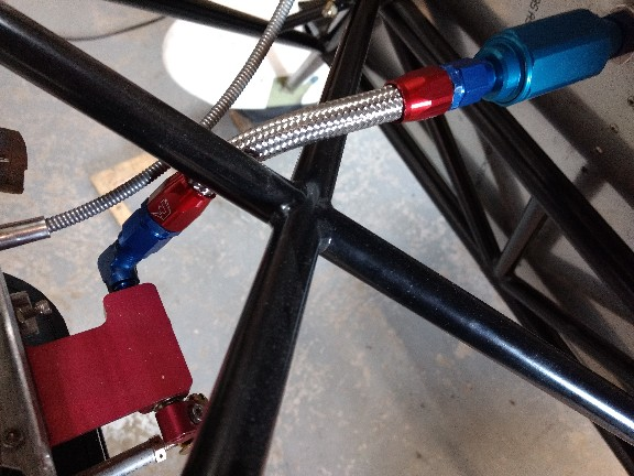

Welcome to the forum VillaAir. I’ve probably got the shortest fuel line in the Sonex universe.

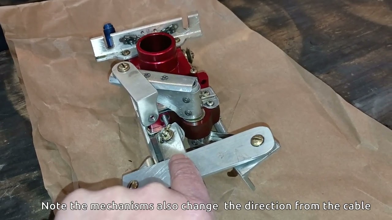

My AeroInjector is backwards compared to most, as I did my own reverser to use Cessna style controls.
The sensible thing would be to use Sonex controls, turn your AeroInjector so the cables connect near the firewall and use an angle AN fitting to get the fuel line a straight shot from the firewall. Try and make the fuel line only go down from the tank to the AeroInjector with no rises or dips.

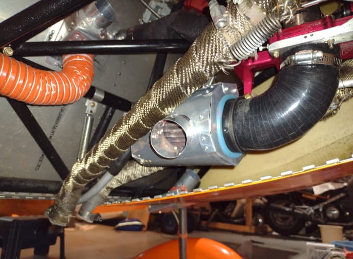

Here you can see my exhaust wrap and if you look close, the fire sleeve over the fuel line:

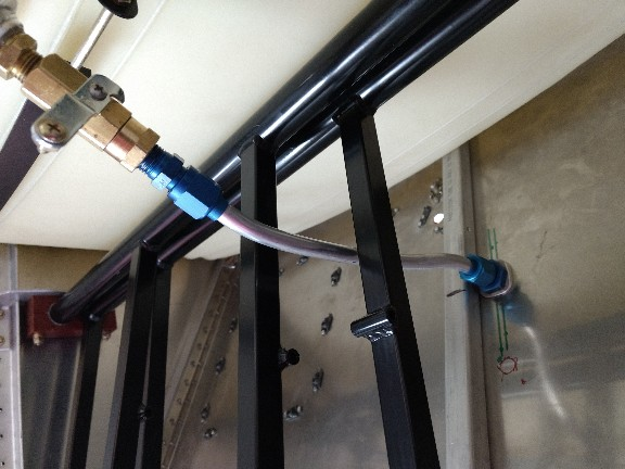

Here’s a view of the odd routing of the fuel line. I pulled back the insulation and there’s no fire sleeve.
I’ll work on this first. I like the idea of double fire sleeve around a flexible line.
