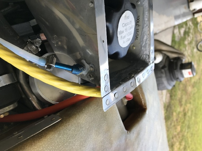

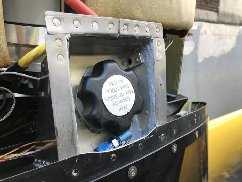

Here are a couple pics of the seal job and the overboard drain I put in today.
I’ll test out the sealing of the fuel cap by picking up the tail in the hangar tomorrow. I guess I could also put a small balloon on the fuel vent tube.
Rick Caldwell
Xenos ph 1 36 hrs powered, 3 hrs gliding
Fuel Pan Sm.jpg (138.99 KiB) Viewed 2064 times
Fuel Pan Drain Sm.jpg (133.97 KiB) Viewed 2064 times

Rick,
That’s almost exactly how I sealed up the fuel-well. In my case I used a fire proof foam to fill all the gaps then sealed it all with pro-seal. Used a larger nylon drain elbo since the intended purpose was to drain off spilled fuel if/when over-filling. Not exactly pretty but functional.
