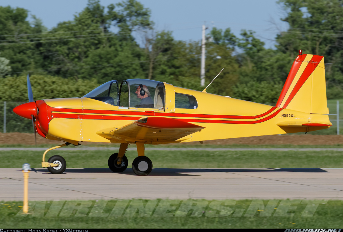

I’ve flown the DA-20, DA-40 and AA-1. All have a free-castering nosewheel. The geometry doesn’t allow the ability to spin around one wheel in tight spaces. They allow a very tight turn, but no pivot about a wheel. I would be more concerned about the additional mass of the castering fork, nose strut and redesigned structural support. The AA-1 has a typical installation. Diamond also has some AD’s on the nosewheel you may want to review.

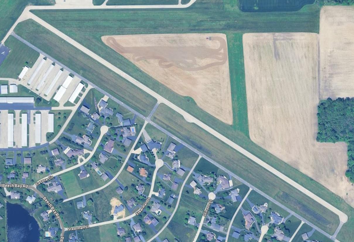

My observations are similar to Dale’s. We have a 50’ runway and with the cutout in the middle, we can do a 180. Straight 50’ width means we are going to be on the grass a little bit on both sides. 60’ is no sweat. You can see the cutout as we call it right in the middle of the runway, a little circular section off the edge. This is 30/12 at C77.
