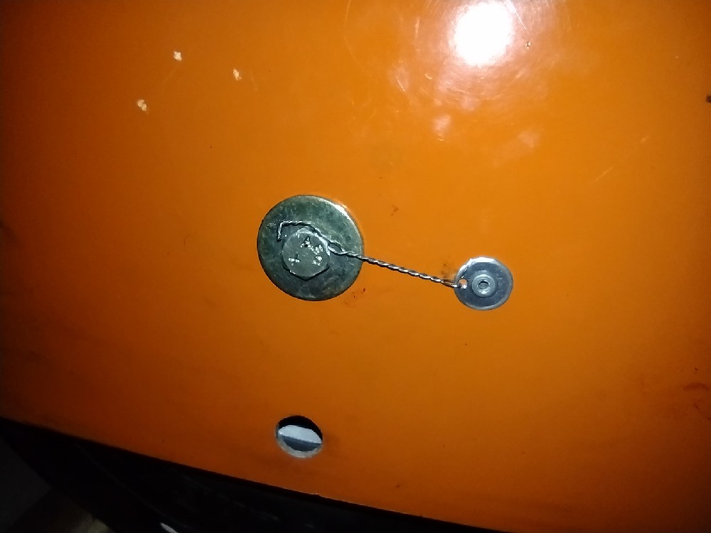

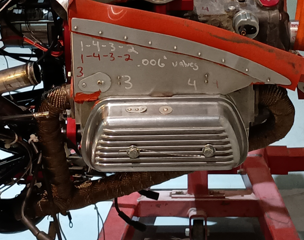

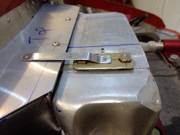

I drilled mine for safety wire.

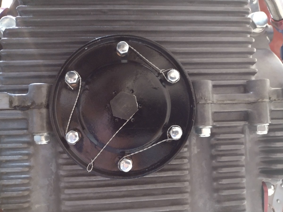

I had a thread on Sonexbuilders regarding things I’ve had to safety. I’ve found some of the pictures.
Wheel pant axle bolts:
Oil sump:
Oil cooler bolts:
Also landing gear fairing pins, pressure sender, definitely the air filter, and probably a couple more things.
